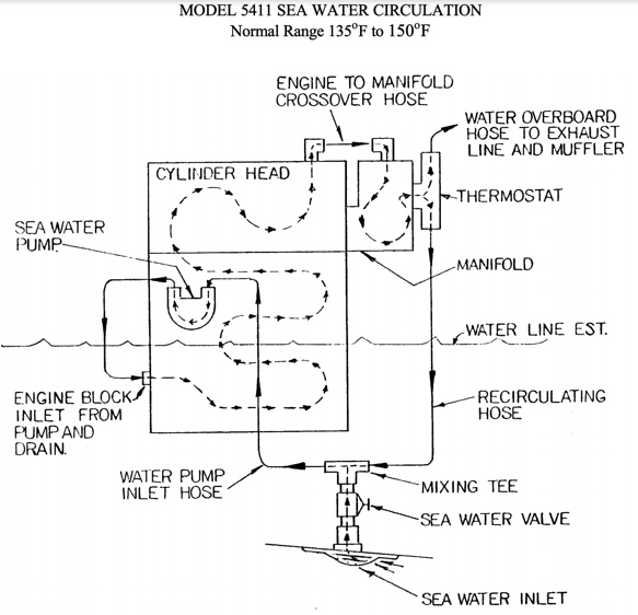

With the recirculation line open, the engine overheats. With the recirculating hose closed, the engine never gets warm.
Looking at your diagram. The critical point is the thermostat. Are you sure that the thermostat is working properly.
Thermostat in your system needs to be closed sending water down the recirculating hose til the water temp gets to 135 degrees. Then the thermostat needs to start opening sending some water out the exhaust and some water into the recirculating hose.
When water temps are above 150 all hot water goes out the exhaust.
I'd check the thermostat for proper function.
This was my thought as well, based on the way in which it malfunctions. However, he did say that he tested the thermostat. Nevertheless, I'd look at it a second time. Since pinching or not pinching that hose is essentially functioning after the manner of the thermostat and achieving the expected result, it almost seems as though it has to be the thermostat.
