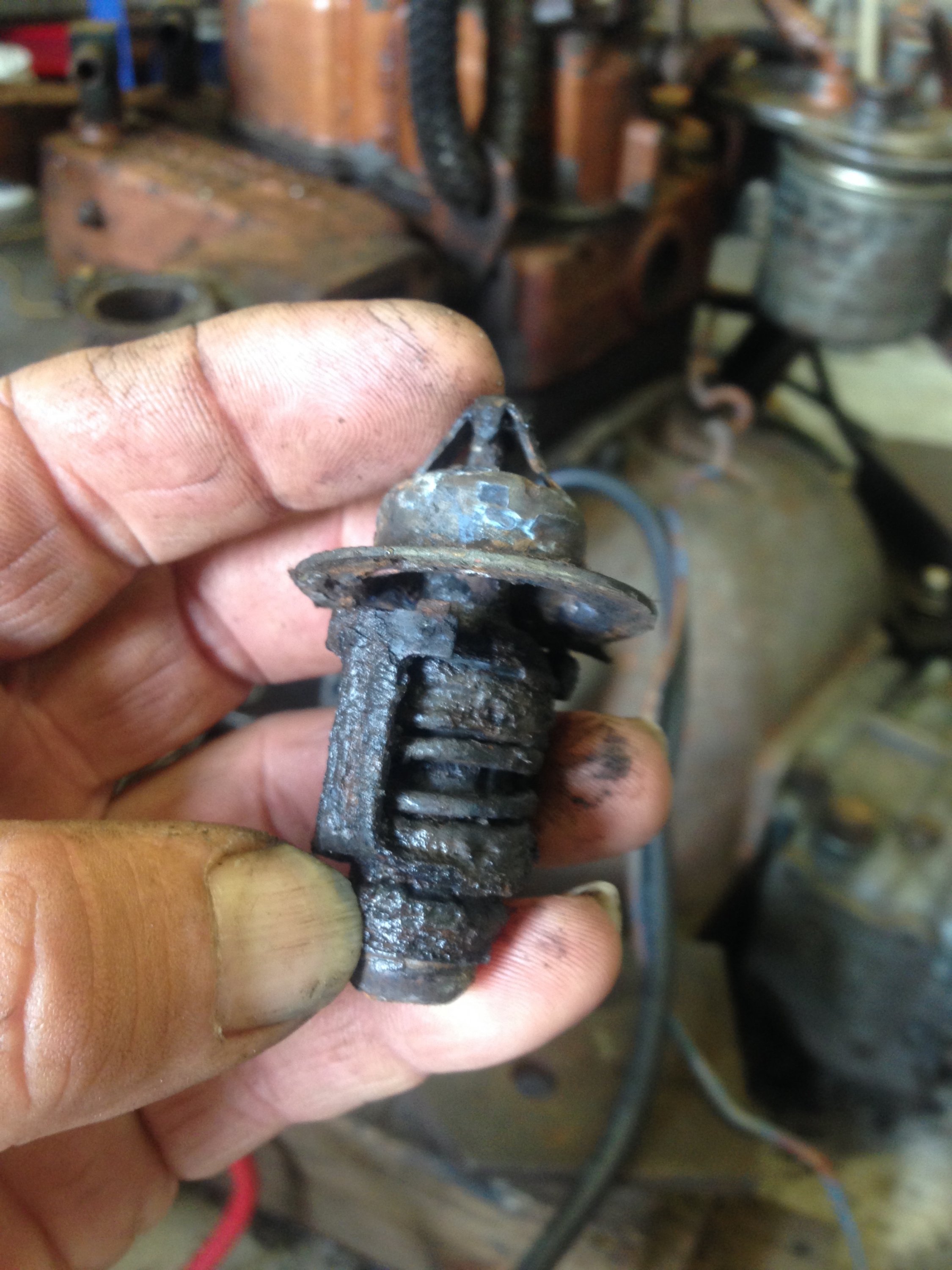

I have read everywhere that the 5411 is a workhorse. I know the engine has sat up for some time and the mechanic was able to get it started, however it appeared that there was some corrosion being flushed out. See the picture below to see what the Thermostat looks like.
