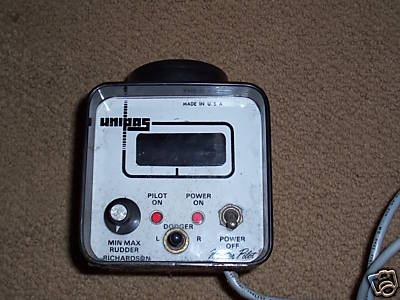

I just won an auto pilot on ebay for $1. I tried to look it up but it must be really old.
I was going to buy a linear actuator from Northern for $125 and hook that up to the rudder post and then have a wired or wireless remote so I could steer from other parts of the boat. But I bid on this and forgot to up my bid but won it anyway.
Does any one have one of these old units? Do these things just keep you on a bearing?
And what does the word dodging mean in regards to these things?

I have not heard of this unit. The dodger function may be a way to temporarily and momentarily change your course to steer around an obstacle such as a lobster pot buoy.

Never heard of this unit. EVER Must be older than me, which is pretty old. I agree that the dodger function is probably for a temporary course change to miss an obstacle. Would also think that one this old would not have the ability to be hooked up to a GPS or have the ability to do more than just hold a steady course in a straight line. The good news is if you end up throwing it in a dumpster, you only spent a buck. Nothing on a boat costs just a buck.

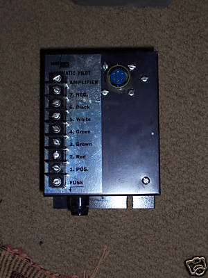

Scott, Interesting old unit !!! I’ve not encountered one.. Looks like the actuator or force generator is the round part and the square part is the rudder feedback system to tell the computer how much and how fast the rudder is moving. The black part probably has the flux gate compass built into it.. The control head dodger is probably to enable you to miss things.. the knob is probably the rudder gain which tells the computer how much rudder and how fast to apply it.. Hook it all up on the floor (careful of re-bar influence) and turn the control head to see if you get a reaction from the actuator.. then turn the black part .. to see if it makes the actuator move.. you may be able to use it for a remote steerer if the auto part doesn’t work and the actuator does.. the dodger buttons may be functional.. I’d be interested in hearing how your troubleshooting with it is going!

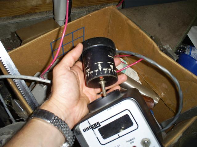

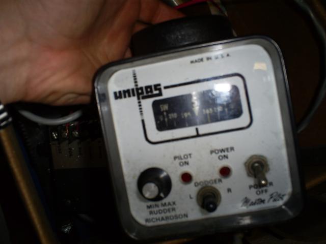

I finally got the thing from the ebay seller. I hooked it up to a bettery. The dodge feature works, and the actuator works. This thing is old, not even any solid state controller. There is a control box that is supposed to have a compass that is suspended from the top and there are some crude sensors to measure it's rotation. The compass and oposing part of the sensor are missing.
It's designed so when you flip the switch to on, a solonoid engages on the sliding track to fix the actuator. And that is your heading. No adjusting no changing course. If you don't like the course turn it off and back on when you do like the course. It is made to keep a boat on a course and not a remote steer the boat as you like device. The travel on the actuator is 6" total. The mechanical parts are fine but I need something to control it. I have a feeling this is going to moved down on the priority list.
I doubt I will be able to find this analog compass piece.

In an incredible act of unsurpassed ebay honor, months after I paid for the unit and it was shipped and I gave positive feedback, the seller tracked down the original owner and secured the missing part and sent it to me. I was absolutely blown away. I have had a very positive experience with people that own boats so far.
I need to hook it up tonight and check it out. Hopefully it will work.
