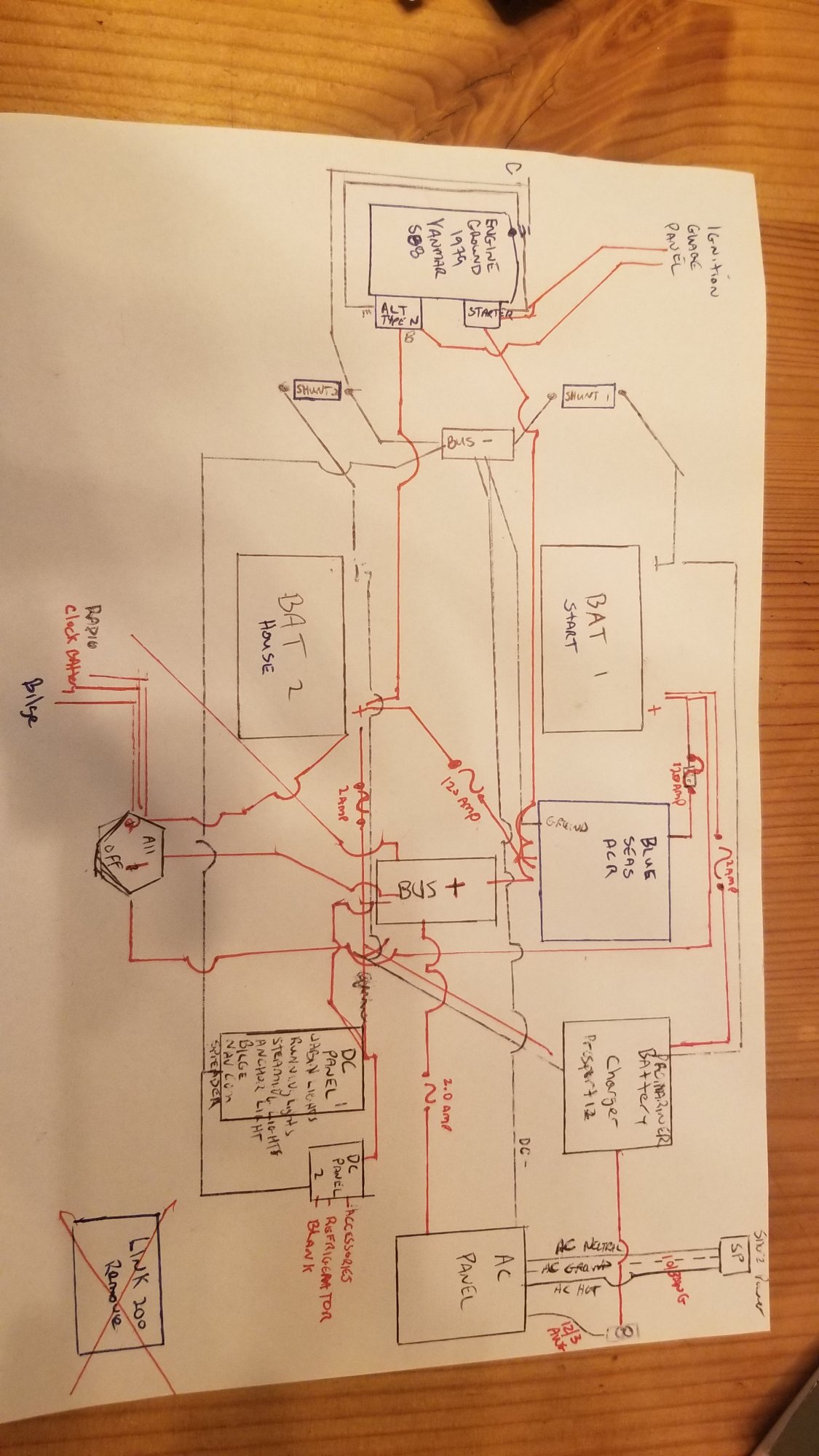

@mainsail, yes I agree with you the Alternator should not be connected to the ACR. I was going to connect to the larger battery. Attached is my electrical schematic. I know I am missing something off the battery switch but this is the general setup. I left out the isolator diode because I was going wire up the acr today.
Thank you
Chris

The red wire that disappears into the case through a vent is most likely a direct connection to the field. Alternators that have internal regulation don't usually have the field connection available as an external connection. I had to make a similar connection on my OEM alternator on an Atomic 4 many years ago when I added a field boost circuit for higher rate charging.
Thanks Rich! I have never even had the boat in the water. I am going to push ahead assume it's has an internal regulator and see if my batteries charge off the current alternator if not I will buy new alalternator and an external regulator.
Thank you for everyone's time and all the current and past posts I have read and digested.
