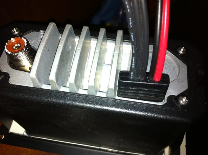

I need to uninstall the cables from my VHF IC- M411.
They are connected through the black rubber (re the lower right corner of the photo)
Can I just pull the black rubber ?

If you pulled the black rubber thing, I'll give you $20 for the radio...Seriously, you should have connections for everything, nearby. Just trace the wires back.

Traced the wires back. Successfully disconnected the 12V cables and the cable to the GPS antenna. Had my dealer program a new MMSI code and will reinstall today.
