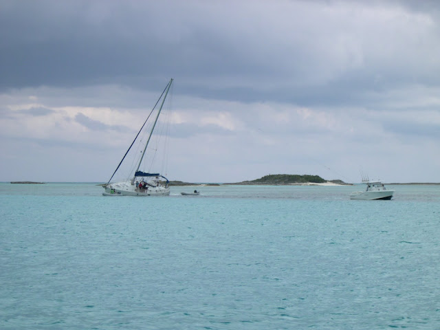

Pulling the boat over by the mast happens quite often. I have not heard of a mast breaking, have always expected the halyard to snap but haven't even heard of that. Here's a picture of a Beneteau (over 40 feet) being assisted by a local power boat to get off a bar in Normans Cay. He got him off too! This was a charter boat. The keel is probably the usual Beneteau shoal draft with the stub wings on it.

You have to ask yourself 'what the hell was the skipper thinking?' The darker water of the shoal area is clearly visible even from this wide an angle. Couldn't he/she see the bottom?? The water is so clear in the Bahamas you can see the bottom at 50'.

That bar in the middle of Normans is very clear. This was the first time I've seen anyone stuck on it. It's a charter boat out of Nassau. They clearly were not familiar with reading water in the Bahamas.

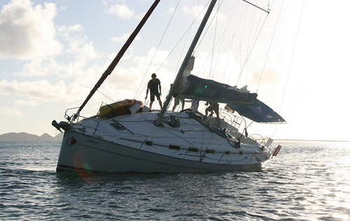

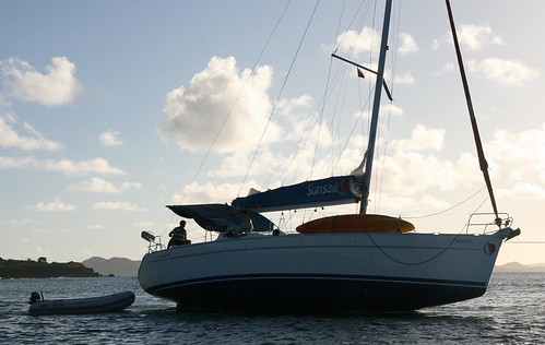

Spanish Town, BVIs
All attempts to go backward, sideways didn't work. After a significant amount of time, the boat sort of bounced through the reef, and into the channel that leads into the harbour. The surf was significant, and the boat heaved fully from one side to the other throughout most of this process.
