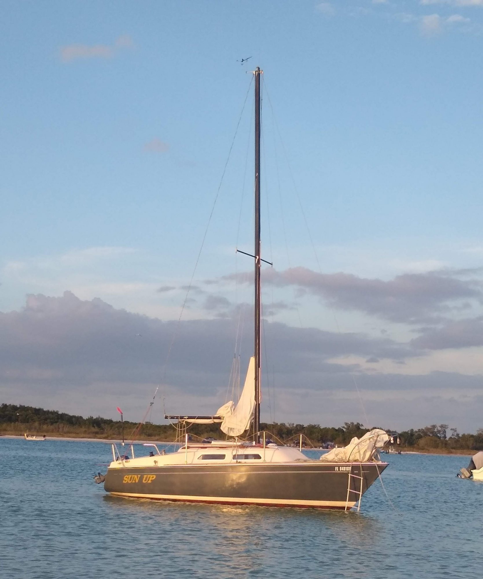

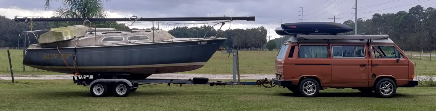

I'm loving the Paceship PY23 which has a 20" draft with the steel stub keel and centerboard. I've had it for 20 years and though haven't been looking, haven't really seen anything else so stable in strong conditions - and maybe I'm missing something so asking y'all.
Are the other other low-draft trailer-ables that one would feel confident in strong conditions 100 miles off shore?
Being able to deal with strong conditions is very important, additionally -
self-launchable
sleeps 4
spinnaker capable

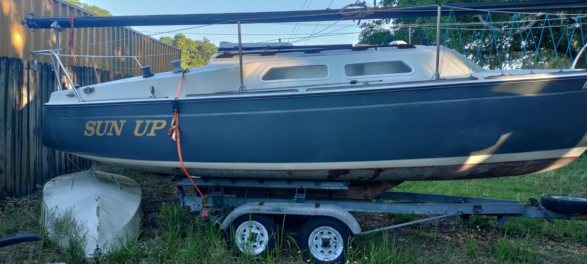

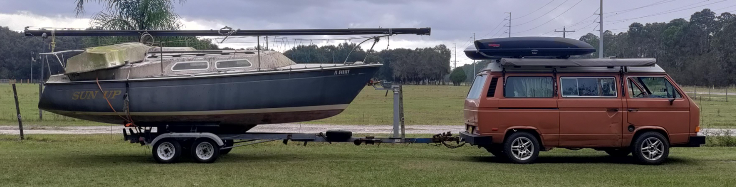

I'm looking at getting a replacement PY23 with a strong deck because my balsa-core deck has several soft spots and getting another hull may be easier than re-coring.
Thanks in advance for your thoughts.
(before cleaning after sitting under a FL tree for 2 years).

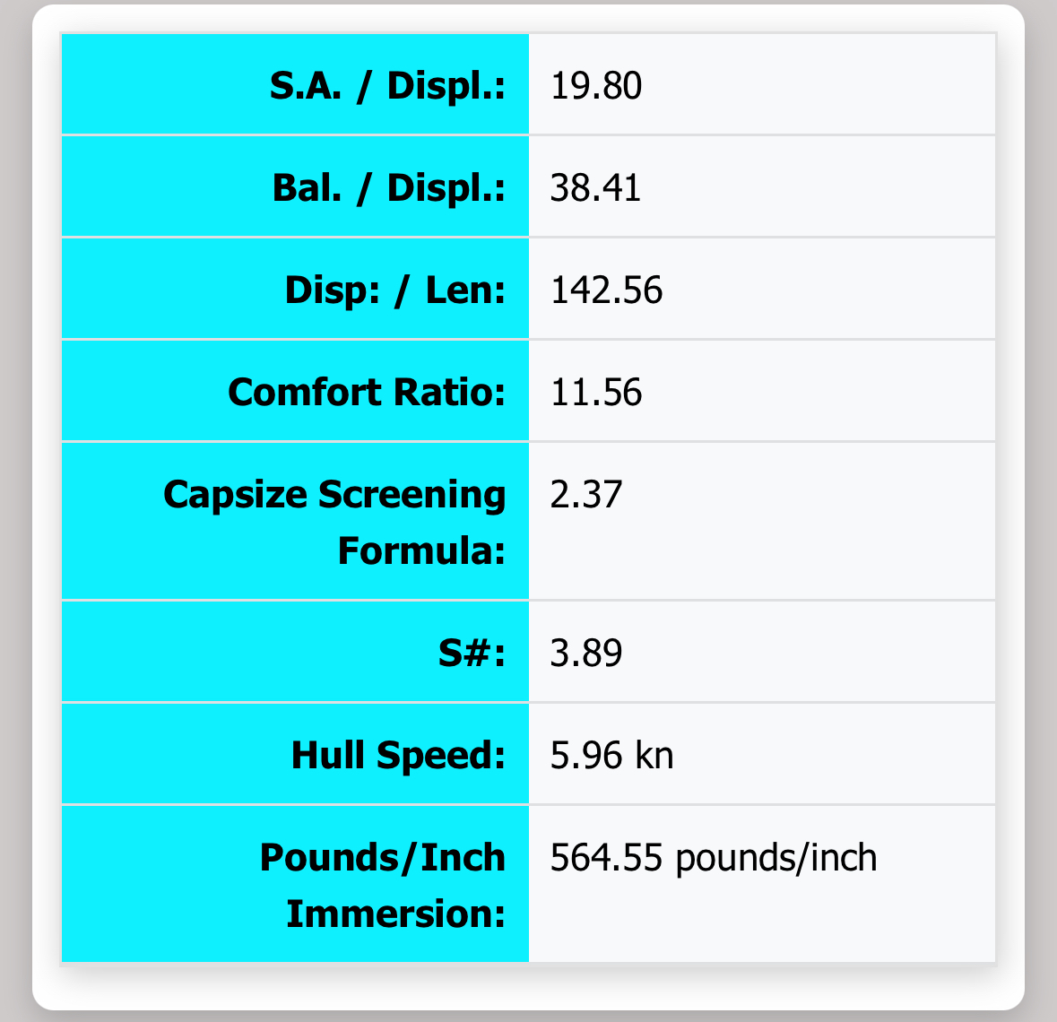

To answer the OP’s question, Sailboatdata.com has a lot of good information regarding the abilities of different sailboats.
Seems the most relevant data point for your question would be a boats “s” number
And here are some stats for your boat
To answer your question, you can compare different boats on the sailboat data website

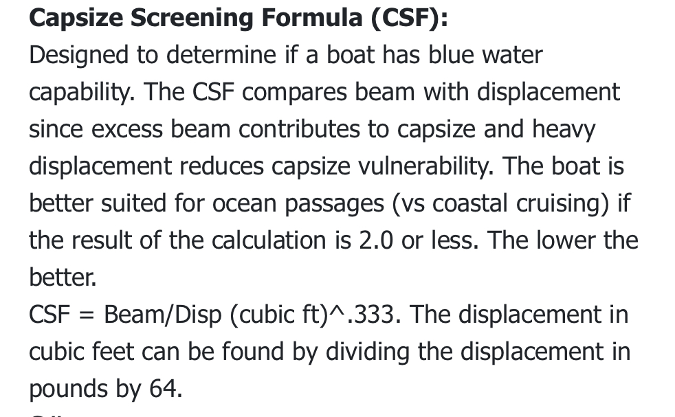

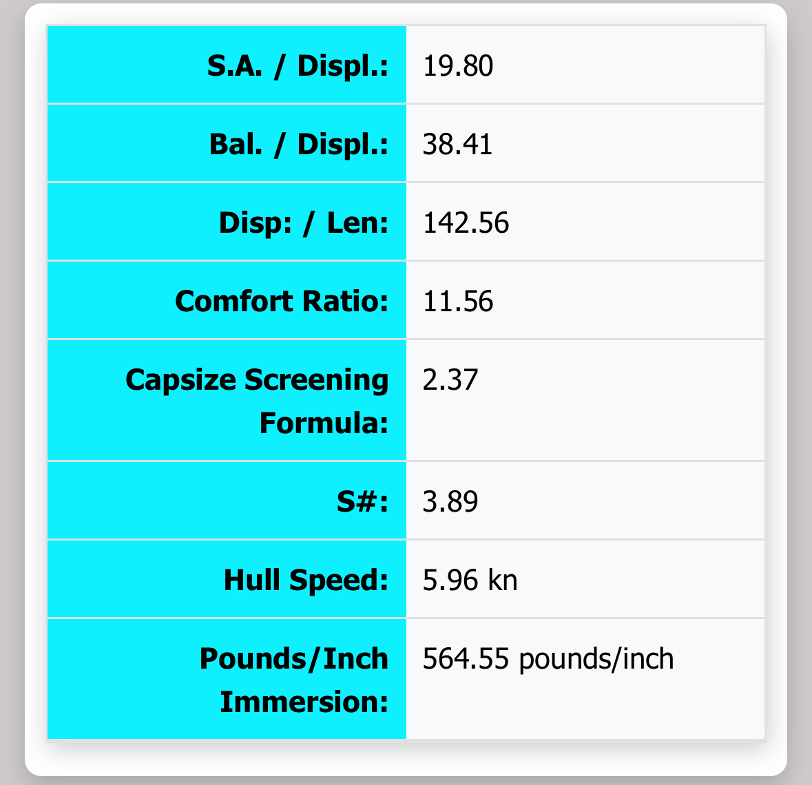

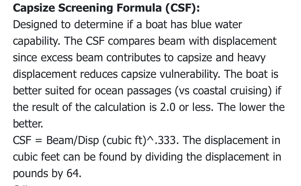

Seems the most relevant data point for your question would be a boats “s” numberView attachment 235637
Can you please elaborate on CSF vs S#? In your post you use the terms interchangeable as do definitions from google search. However, the image you provided has a CSF of 2.37 and a S3 of 3.89 so those terms/numbers can't be interchangeable.
23,942
You are correct, the terms are not interchangeable. They look at different boat characteristics.
The CSF rating looks at the boat's hull design. It compares the beam and displacement numbers of the boat to provide a Capsize ratio. How vulnerable is the hull design to capsizing in open water during dangerous sea conditions?
The S# is used to compare the sailing performance of similar boats of comparable size.
