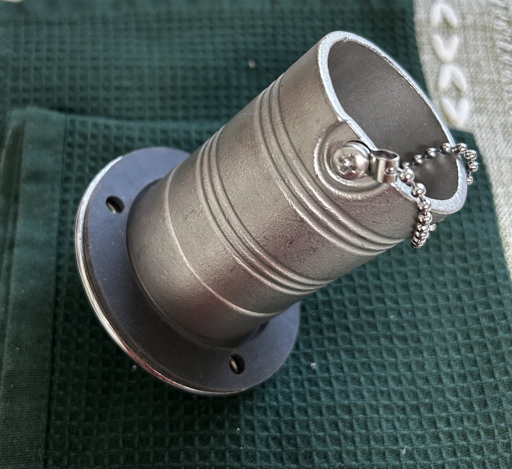

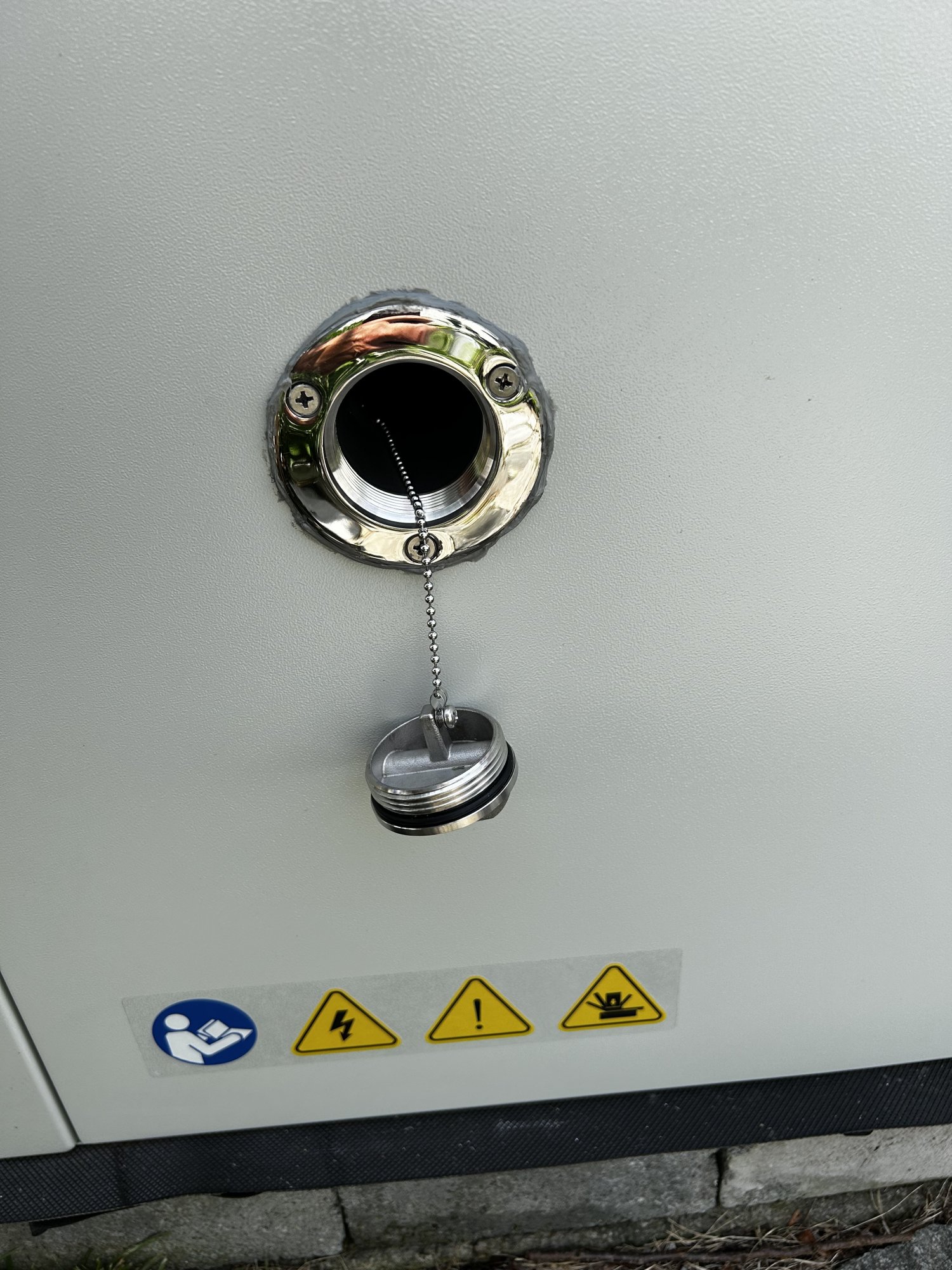

When using Bed-It Tape to install a Deck Fuel Fill, do I use the supplied Fuel Fill rubber gasket with the tape or just the Bed-it Tape alone?
This is a different sort of installation……

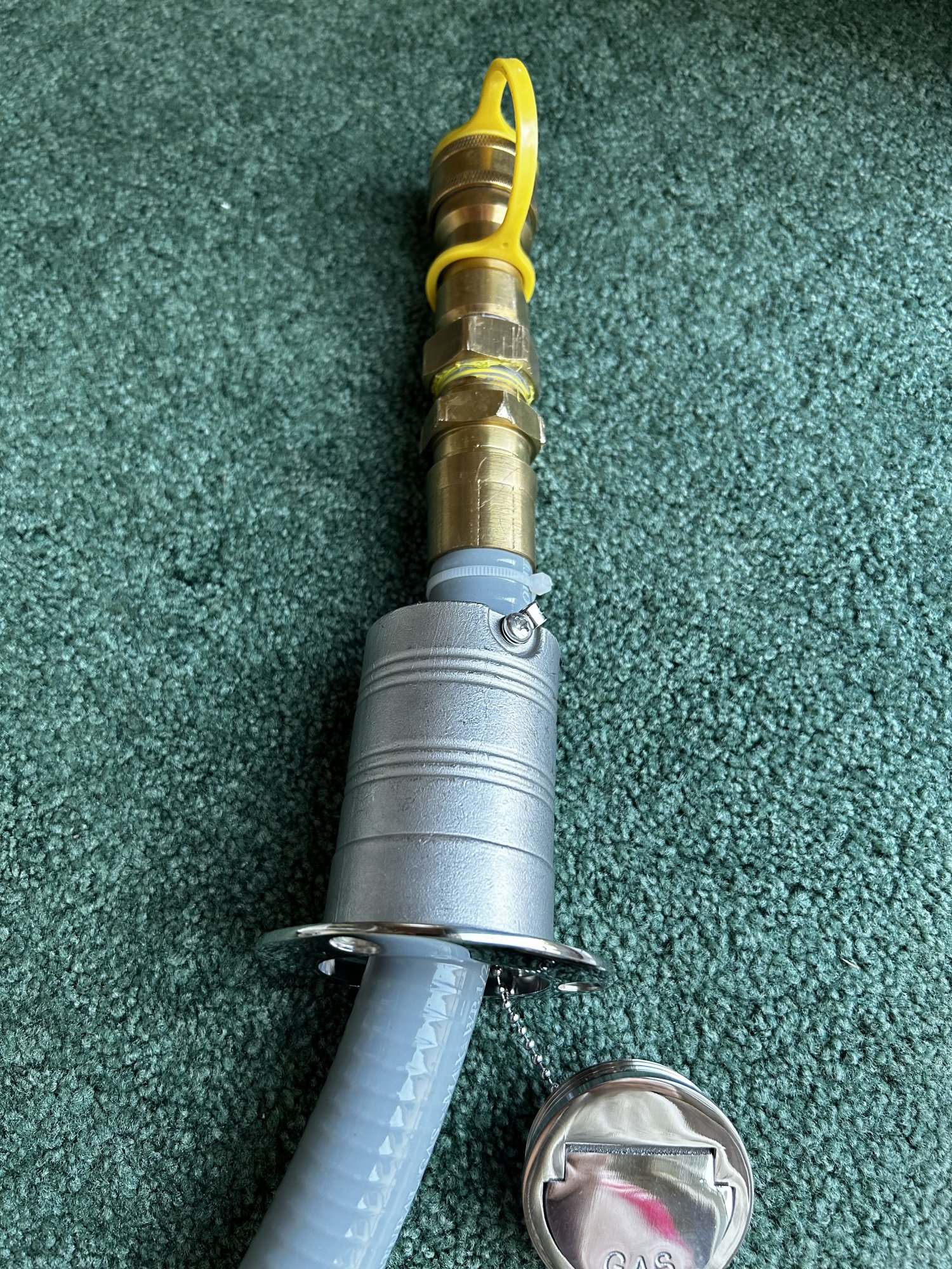

What I am doing is installing a 2” stainless steel deck fuel fill with approximately a 3“ long neck into a generator enclosure at my home.
I am using this as a pass through access for a 3/4” Natural Gas Hose to feed the generator. No hose will be attached to the fuel fill neck, its just access into the enclosure when needed.
The nature of the 3/4” Natural Gas hose is so wide and thick it will not bend into a tight corner. It can curve perfectly but just not bend.
So the 2” Fuel Fill inside diameter opening is wide enough to pass the hose through with the Quick Connect fitting attached and I end up with a straight run from my home supply directly onto my generators intake.
The aluminum wall it is going to be mounted to is just over 1/8” thick, with a lightly textured finish.
And it is being mounted Horizontally and through bolted. Not screws.
I ask because I want a weather tight seal.
Thank you in advance for your help.

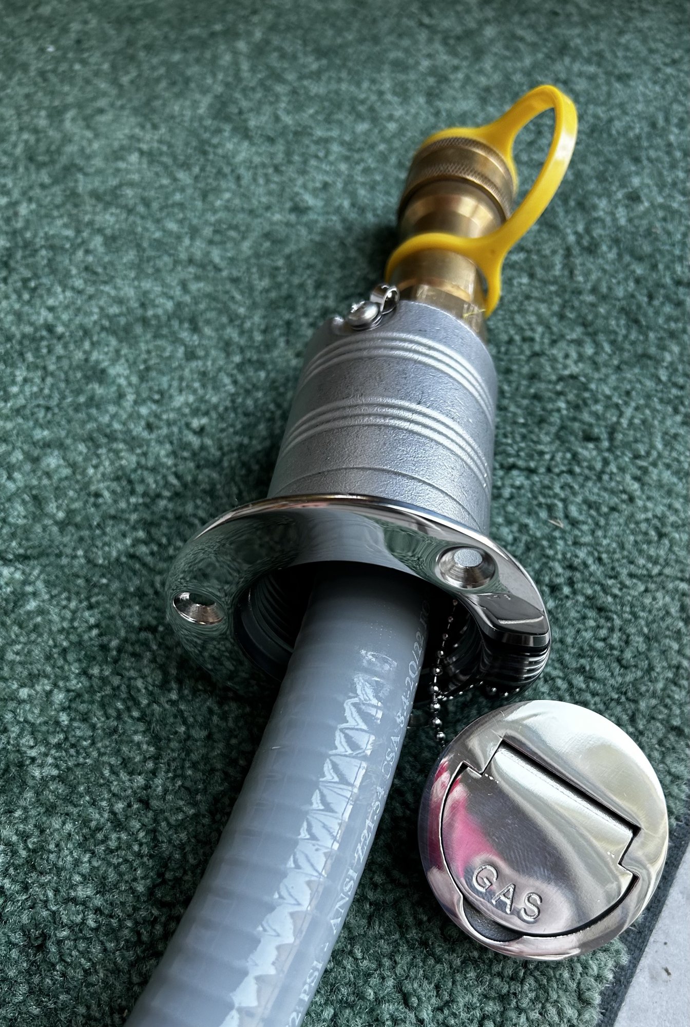

Your second picture shows that the edge of the stainless metal is wider than the rubber gasket. If you kept the gasket, there would be a gap. I would remove the gasket. You also need to use (much) more than one layer of bed It. I would take "gobs" of it (gobs = technical term for lots!:)) and roll it into lengths so you can deal with the appropriate thickness, and then wrap it around the tube, against the ss flange and the wall. Bolting is a very good idea and actually required for Bed It. I have re bedded deck hardware successfully with Bed It.

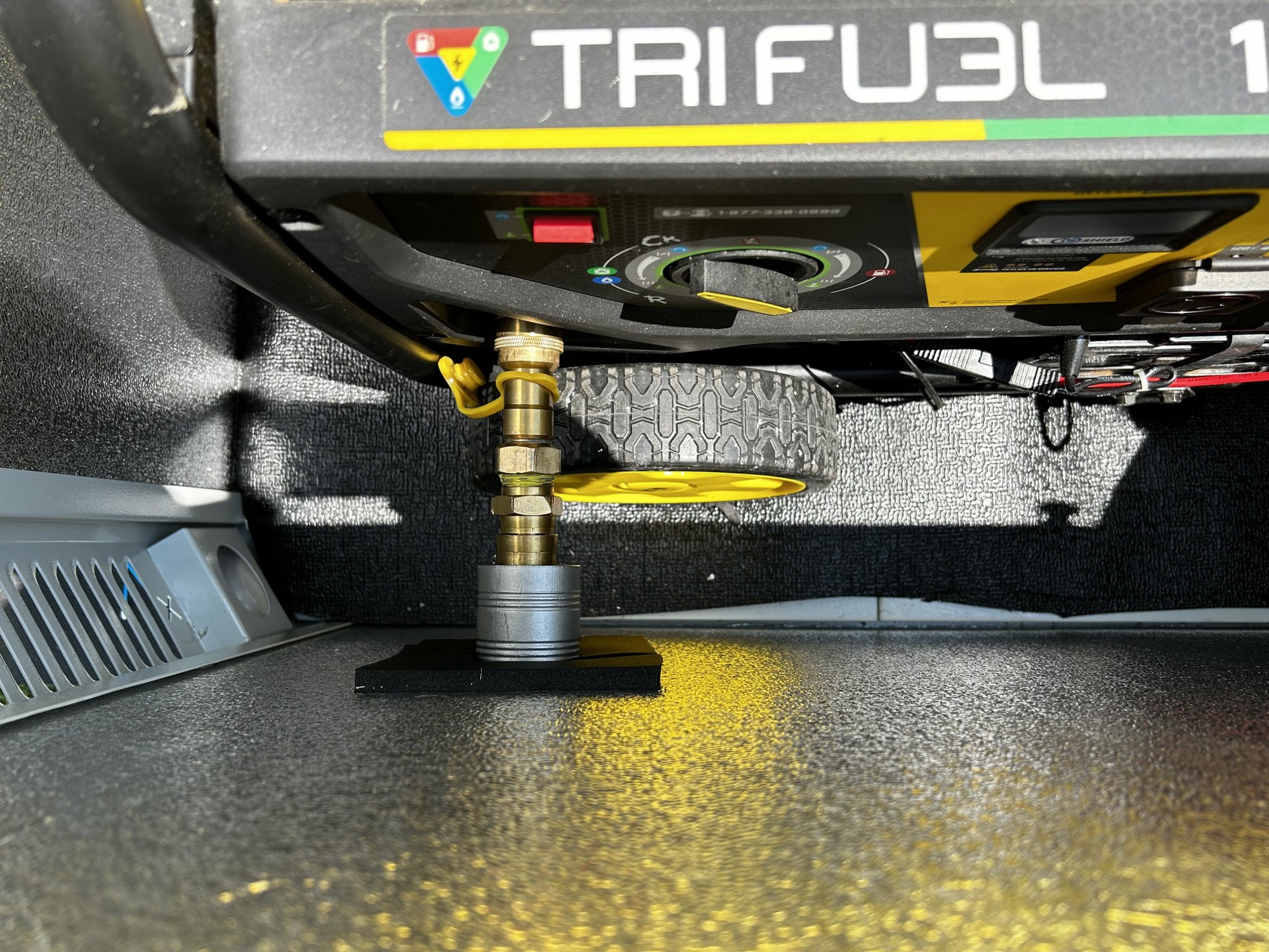

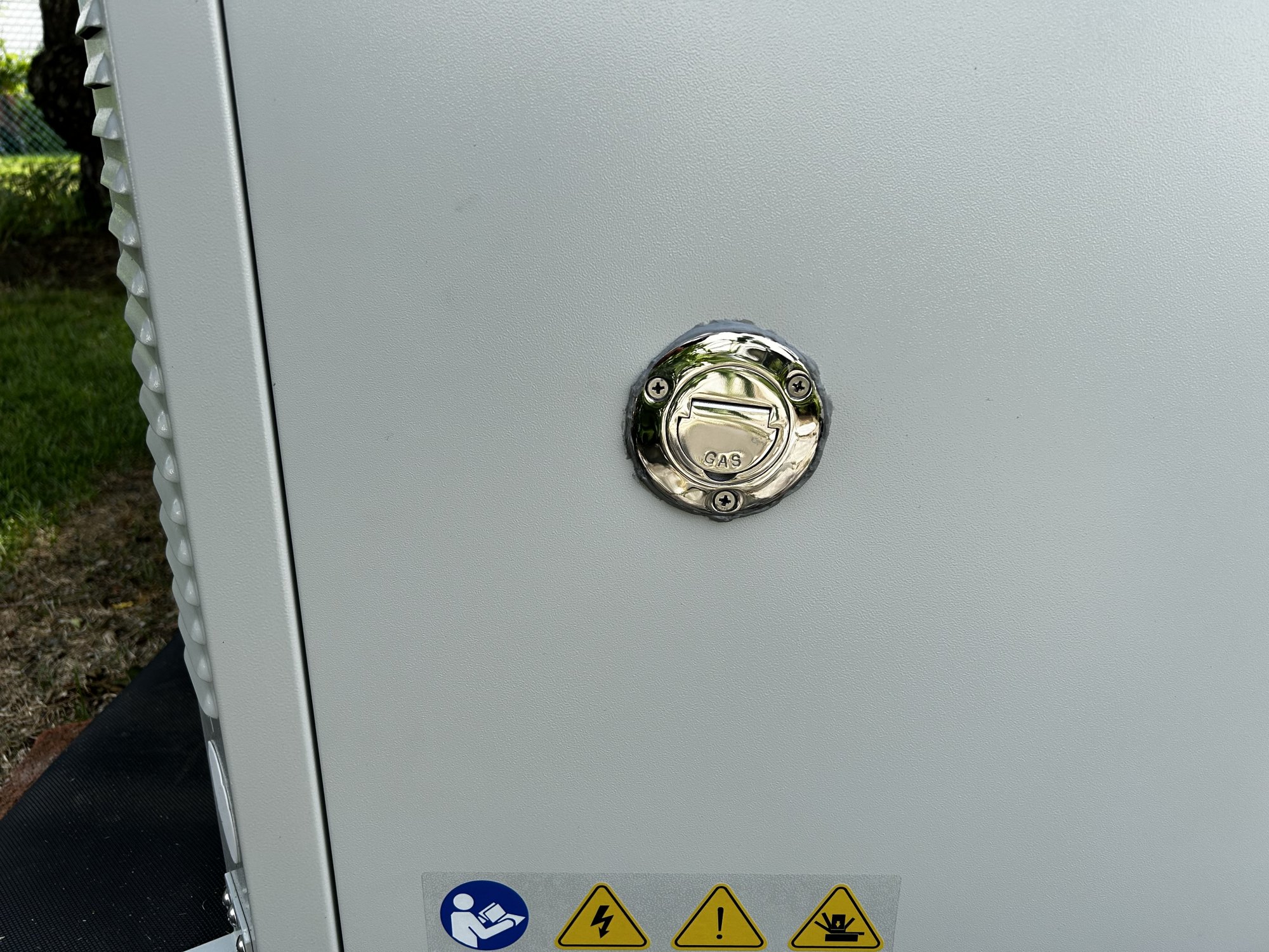

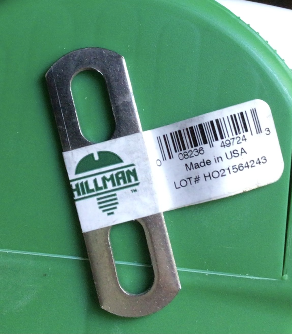

Greg, it is through bolted. I also thought getting it to compress was going to be my issue as well, being a horizontal mount.
But I cut out the insulation on the inside much wider than the 2 inch opening and attached 3 stainless slotted flat stock tabs on an angle to the bolts. This gave me more area to hold against the wall.
The Bed It Tape sealed on both sides and holds fast. I’m happy with the results, as this will never see any diesel or gasoline the seal should be good to the weather. There is no weight applied to it, as a pass through for my natural gas hose, the hose stays centered in the Deck Fill (I measured for that more than a few times) .
It’s unconventional, but meets my needs.
I do have to add that the excess tape is tough to clean up from the textured aluminum wall.
Thought you’d like to see the finished results
Likes: BigEasy
24,883
Looks like it works.
Try a plastic scraper like this to remove the excess back to the edge of the cover.

Looks like a good application.
A scraper or a pocket knife will clean the excess tape around the fill port.
