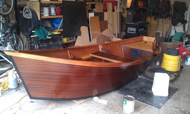

It seems that a lot of the wooden boat people swear by this. They mix a 10% graphite in epoxy and paint it on the bottoms of their boats. The graphite provides UV protection and the slick bottom allows the boats to be dragged over rocks and beached without hurting the bottom much.

I have used the West Graphite additive with epoxy on the plywood bottom of my dink - especially since I have both on hand and don't always want to spring for a can of bottom paint It works pretty well It does stand up to dragging on the beach It is easy to apply It does need recoating - probably becuase of the sun on it in the off season You can sand it and use bottom paint over it My dink is in all season The growth on the bottom is reduced but not eliminated I still give it a scrub when I do the bottom of Artemis - about every two weeks It hasn't worked well enough for me to consider putting on the bottom of the keel boat
