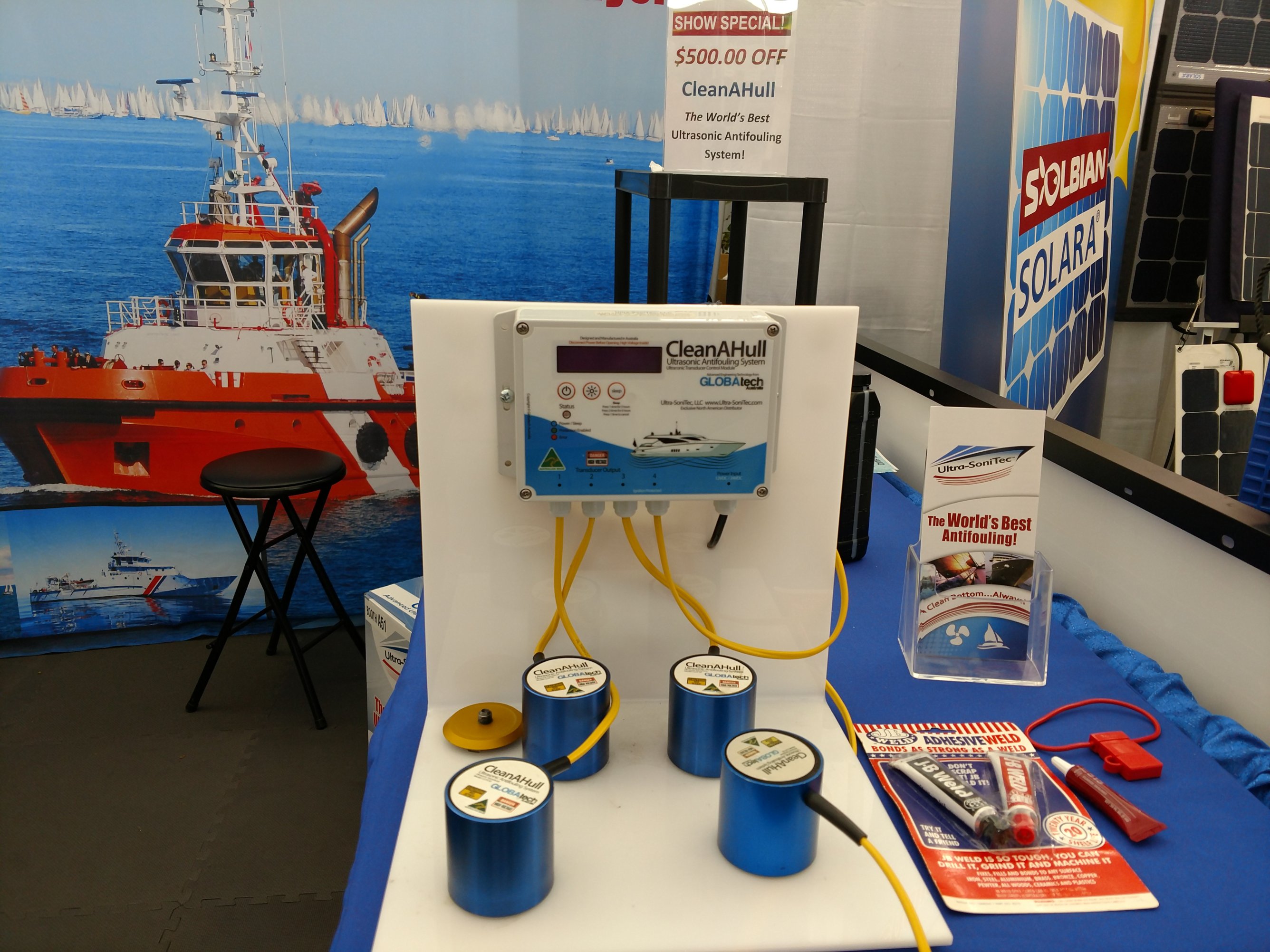

So I went to the boat show today with no particular shopping list and I found something interesting. There was a device that uses ultrasonic waves to keep marine life from attaching to your hull. It runs on 12 volts, has low current draw and for my 27 foot boat needs 2 transducers according to rep. So my first instinct was to ask this forum if anyone has had any direct experience or knowledge about this device. Do you or anyone you know have this installed on your boat? I anxiously await your responses.

what are they offering as proof of statement?
$500 off show special, good lord what are they asking for it?

They wanted 1800 for the 2 transducer system. They swear it works as long as you keep it on. No more bottom painting. They dropped Nigel Calder's name as a supporter. That is it. That is why I am asking the forum for input.

They've been around a while. If it was such a great idea, you'd see a lot of power boats using them (where money isn't an issue). I'm leary about them doing the job.

These systems, in one form or another, have been around since the 70's, at least. One would think if they had even the slightest benefit they would be OEM on every vessel launched! Or mandatory in places where the environmental regulations are destroying the effectiveness of antifouling paint.
Snake oil indeed!

Ultrasonics do clean. So does the running vibrations from my engine and genset.
It is all in the amount of Sonic energy applied to your hull.
Two transducers? Not for my boat size.

I work for a company that manufacturers ultrasonic plastic welders. We use water for load testing - putting the test horn in a bucket of water. If you look at the inside of the bucket, over time, calcium gets caked on to the plastic bucket. It also tends to build up on the test horn, but that typically wipes off. The one bad part is that the test horns get pitted from the motion of the water against the horn surface. There is another significant issue. To make the sound waves travel through the material, it has to be resonant. Otherwise the motion will not carry very far. Your plastic boat surface is not going to be resonant. I could see this working on a prop, but it would need to be much greater power - like in the 1000 watt range. Even so, when you finally have enough amplitude to work, it would be prone to inducing cracks in the prop.
