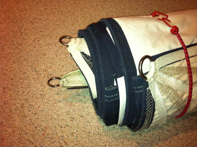

We have a 2002 Hunter 356 that we sail on the Chesapeake and take the sails off each winter. The top webbing loop on our jib blew out a couple of years ago in 15-20 kt wind while heavily loaded. We took the sail to the UK/Halsey sail loft in Annapolis for repair and the sailmaker recommended strapping in stainless steel rings to replace the head strap and the tack strap. They have worked fine with the furler. I happened to have the sails at home and have attached a photo of the 3 stainless steel loops (the clew already had a loop).
