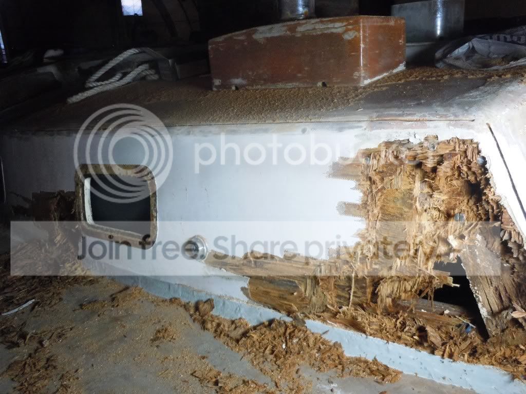

Oops, found some unpleasantness with the Mariner yesterday as we turned our attention to the topside. Was tapping the house and found a soft spot. dug the glass away and found this:

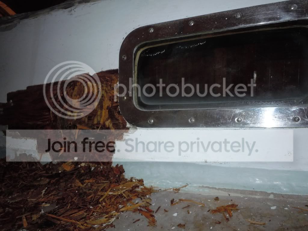

and this:
so, not wanting to do things in a half-assed fashion, we're going to cut out and replace the offending cabin wall completely.

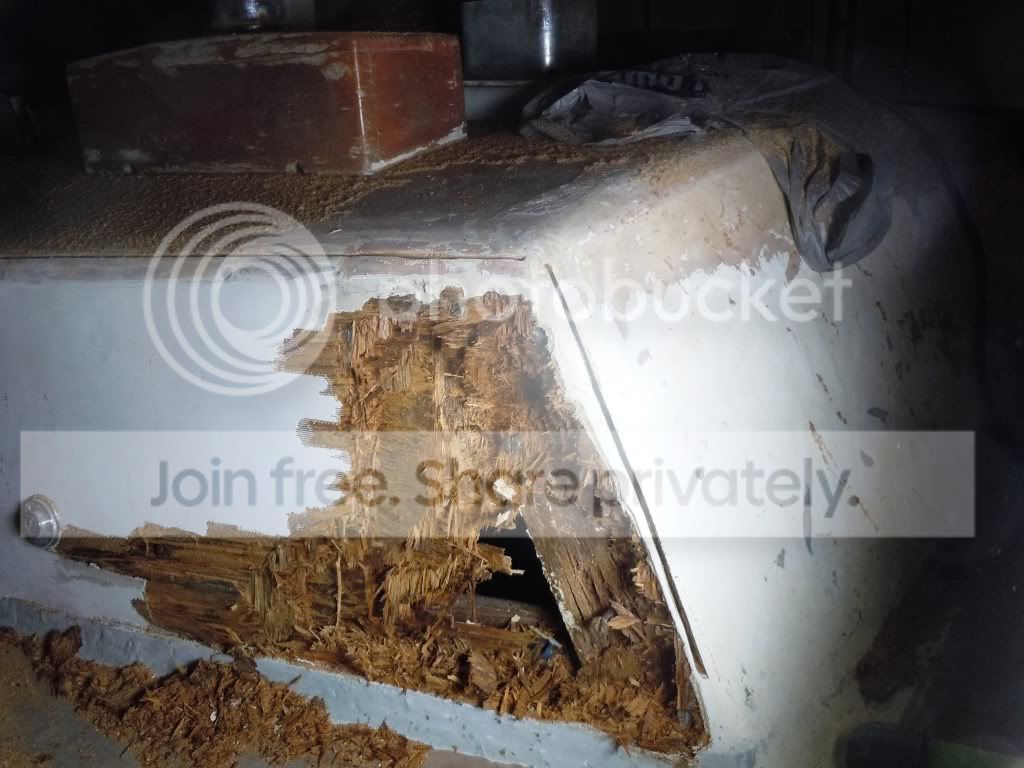

You can see the initial cut lines here:
and here:
Not a show stopper, just a temporary setback. I supposed we could've soaked the mess with CPES and glassed it over but that's not how we roll.
