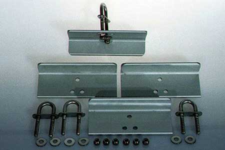

Now that I am getting ready to do the u-bolts, As well as drilling new holes I have 4 old holes to fill. My first thought was marine tech. But do to the drying time and being a weekend warrior I am thinking there may be an epoxy that I can use that will penetrate some of the soft wood in the old holes to help firm it up. Any Ideas?? Especially ones that expedite the project and give me less time with my shrouds disabled.:confused:

Thanks Shell. I appreciate your detailed response(s). Alot of the reason I am changing to the u-bolt is the much larger backing plate that is also a angle iron (stainless). :)
