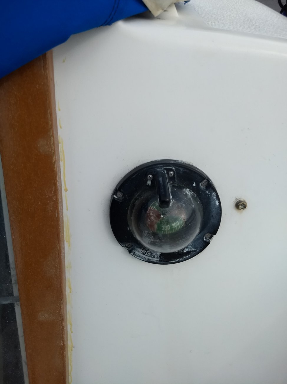

I am considering replacing the bulkhead compass in my 1987 Hunter.
What have other compasses have folks tried, since the compass with our model is no longer available?
Many modifications to make the replacement compass fit?
Or should I try to send it in to get refurbished?

Try ebay. There are hundreds of choices. I purchased a new Ritchie bulkhead compass at auction for $14 and a rebuilt 6 inch binacle for $165.

If it’s mounted the way i think it is, you’ll have a hard time finding a new one for your hole. I found a used one from somewhere in the Midwest. I’m doing my best to remember the dealer. I’ll post his contact info if I can find it.

Finally got a picture of the Suunto. Looks like the Richie Venture SR2 is a little bit bigger bulkhead hole and the Plastimo mini compass is smaller than the present bulkhead hole. I guess the blue light of the Richie is ok.
