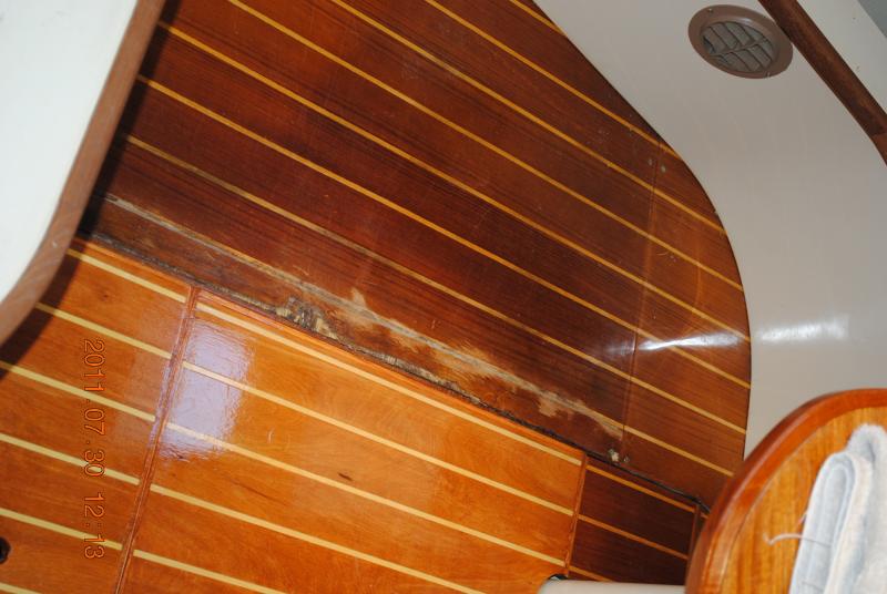

the bulkheads are plywood. Teak plywood is VERY expensive. I've found that if you sort through the pile you can find cabinet grade oak that has a straight grain on the back side that, with the application of teak stain, is a pretty close match. You will undoubtedly encounter the "old wood is bleached out and the new wood is not" problem also so matching the new to the old with stain is also helpful.
here are the sole boards I re-did due to water damage. new is on the right over the bilge and old is on the left
Jun 6, 2006
6,990
oops, picture got rotated, new is on the bottom and old is on the top
