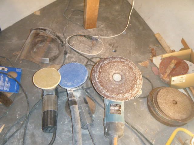

Feb 6, 1998
11,772
Makita 9227C, hands down, for gelcoat.. Hitachi makes a similar one that will go as slow as 600 RPM but all the others, like DeWalt & Milwuakee, start much faster and 600 is a very useful speed for a novice.
That Amazon deal is good I think I paid more for my 9227C 10+ years ago..:doh:
