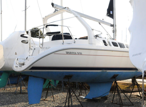

Hi all, I have a question about docking. I have a hunter 310, and an L shaped dock at the end of my pier. The pilings are plenty wide and both ends of the slip are open, But the outer pilings are 24' apart. How would you tie up. This dock is on a creek with little tidal difference. I've been told maybe a foot of wind driven tide.

will help keep your boat in the center of the slip. From the picture, I don't see a problem with your stern lines crossing and wrapping around each corner to reach the cleats. If concerned, add some chafe covers at areas of potential chafe.
