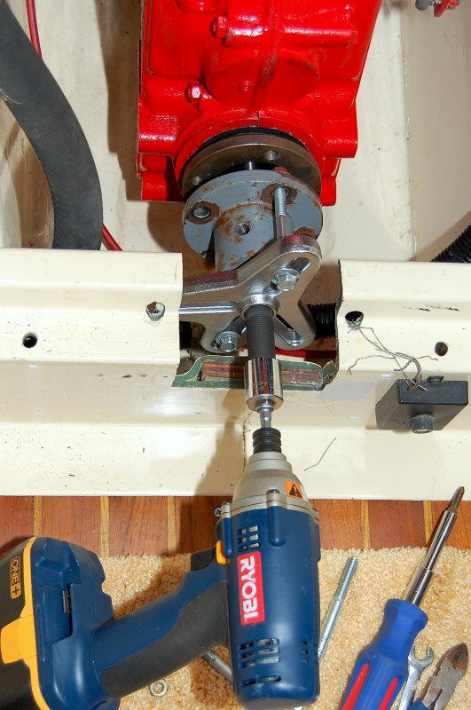

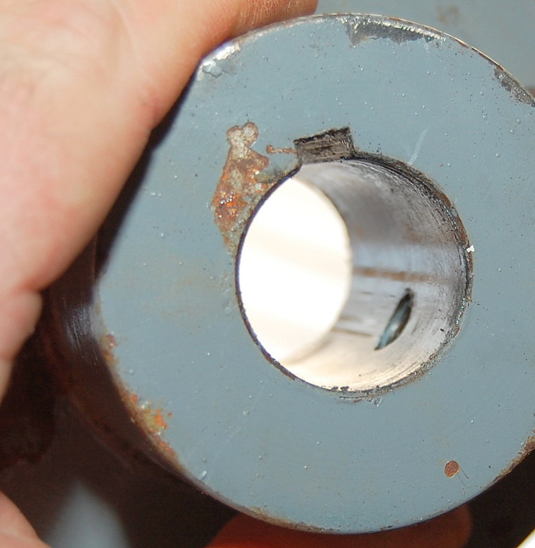

As promised a loooooong time ago I am reporting on the use of Tef-Gel on the prop shaft coupling. After two+ years my coupling came off 100% rust free and with all the original tolerances intact and not destroyed by a thin layer of rust.
Prior to installation I coated the inside of the coupling, the key way, the key and the shaft with a liberal amount of Tef-Gel.. While most of it was wiped away by the very tight tolerances when assembling it the anti-corrosion abilities were unharmed. After removal both the shaft and inside of the coupling have a think feeling, extra tacky layer of protective Tef-Gel.
Mike the manager at my prop shop thought for sure the Tef-Gel would have been totally wiped away and would add noting but it survived. The nice thing about Tef-Gel is that unlike Anti-Seize products that contain graphite or metals it does not add to galvanic corrosion issues.. It also works very, very well as a rust inhibitor..
My coupling came off like it was new with NO penetrating oil and only two bolts with my gear/hub puller.

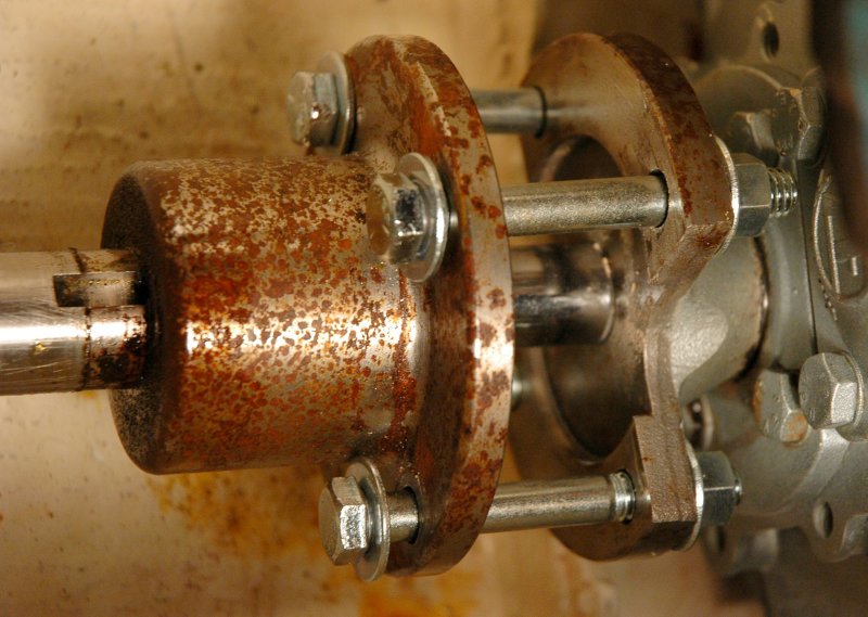

On my last boat, which was brand new, I ran it for less than three months then hauled to change to a PSS. In just three months of use the coupling was already rusted on!!

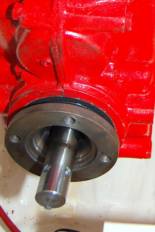

After two plus years it came right off:
No RUST!
The Shaft:
Better Lighting Showing NO RUST!!
This photo shows NO Tef-Gel after just three months (note the rust adhered to the shaft that broke off the internal surface of the coupling):

The surface corrosion isn't the problem. It was the corrosion between the coupler and the shaft that was probably the real culprit. When steel rusts, it expands about 10%... and a 10% expansion in a tight tolerance piece like a shaft coupler makes it effectively un-removable.
11,772
You mentioned that the first shaft coupling (the rusty one) was on the "first" boat but the second shaft coupling (the clean and good looking one) was, I guess, on the second boat, so my question is "are the shaft couplings different?"
And, if they are different, how do you be assured they have the same metalic composition?
Another question, being unpainted, could the first one have had some amount of salt water on it where as the second one, no salt water?
Other than that, looks like another good test write-up. Those are some really good looking photos.
John,
The couplings are the same exact part number only one was initially painted and the other was not. Even the painted one got a little banged up during install and suffered surface rust. Both couplings were in similar installations & both had dry bilges and PSS shaft seals though the first one spent three months with Gore GFO before I switched over to a PSS. 90% boat bilge humidity will do stange things to unprotected steel...
The rust I'm referring to is between the stainless shaft and the inside of the coupling. I could really care less about the exterior. This fit tolerance, between shaft & coupling, is a machined tolerance out to the ten thousandths of an inch so any rust can destroy the fit and make for a loose fit which then creates wear due to allowable movement. Most often a used coupling is thrown away because it can't be re-used. Many times shafts are cut and destroyed because the coupling refuses to come off. This ads a HUGE expense to a simple task like replacing the shaft log hose. $12.00 worth of new stuffing box hose and $800.00 worth of shafting! A little Tef-Gel can help eliminate this..
