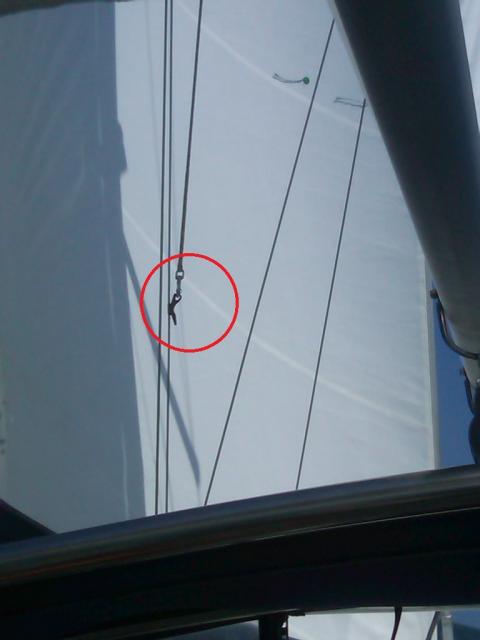

The red ovals on the attached photo show the location of the grabrails I am considering. I am also nervous about self tapping screws, especially as I don’t know what material is behind the outer F/G. Whilst my daughter is only a flyweight lady, some other guest weighing a lot more may hang onto it.

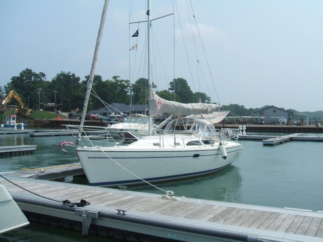

I use a Padeye in front of the mast to attach the spinnaker
Hi Albanach: I am also wary of grab rails with self-tapping screws. People (lightweights and heavyweights) will grab on anything they can find when off-balance. On the spinnaker halyard, I mounted a folding padeye in front of the mast - three possible uses: the spinnaker halyard is fastened there, it doubles as a harness attachment point and I can mount a block there for spinnaker dousing. I have only used it for the first item. See attached picture if you can enlarge it.

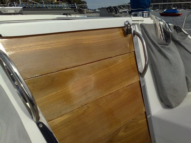

Thanks, rpwillia. Had a good suggestion from Paulj re attachment to s/s washboard brackets. Could use the locally available s/s GRs there. Just evaluating if the brackets's screws would provide strong enough anchorage.
I believe it and that settles it! Actually that is a pretty good idea. I would think those screws should be strong enough. One thought would be to take those metal boards off, drill the holes and screw those handrails in from the back and then re-install.

"One thought would be to take those metal boards off, drill the holes and screw those handrails in from the back and then re-install."[/quote]
Those were my thoughts too - thanks again.

Thanks again, paulj, for your idea. Attached the completed project. Was good timing too, as the screws' sealing had deteriorated (and they all seem to be screwed into the wood core behind the few mm of f/g. The re-fixing with sikaflex has also given it extra strength – not only as a hold, but also against thieves.

Handles look top drawer.
I fell once on steps and after I installed this..... haven't fallen since on the steps.
