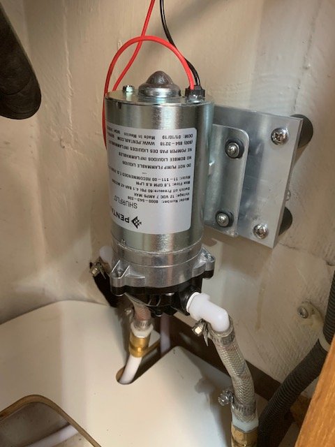

If your water pump is mounted to starboard under sink, that panel acts like a giant speaker cone. I replaced my pump, hoping for quieter, but no success. A 3/8" aluminum plate bolted to the panel with soft washers, and pump mounted to the plate significantly quieted things down. a little mass changes the natural frequency of the "speaker". /Ed
Ed - any chance that you could send a picture of your install once back on the boat?

You could try some ant-vibration mounts for your noisy water pump. If you can feel the "buzz" from the pump in the nearby cabinets this may help and they are fairly cheap. There are stud mount style which should easily replace thru-bolts. You need to select the appropriate size for the mass of the pump. If you have a 4 pound pump, the mounts should accommodate 1 lb each (assuming 4 mounting screws)

Sorry for the delay. Here is the pic of the pump with the sub-plate and additional damping pads. If I did it again, I'd use a larger, heavier plate as the mass is critical to damping the sound. The cabinet panel really resonates.
I also purchased an accumulator which will help with small water draws without the pump running. I'll install after launch.
