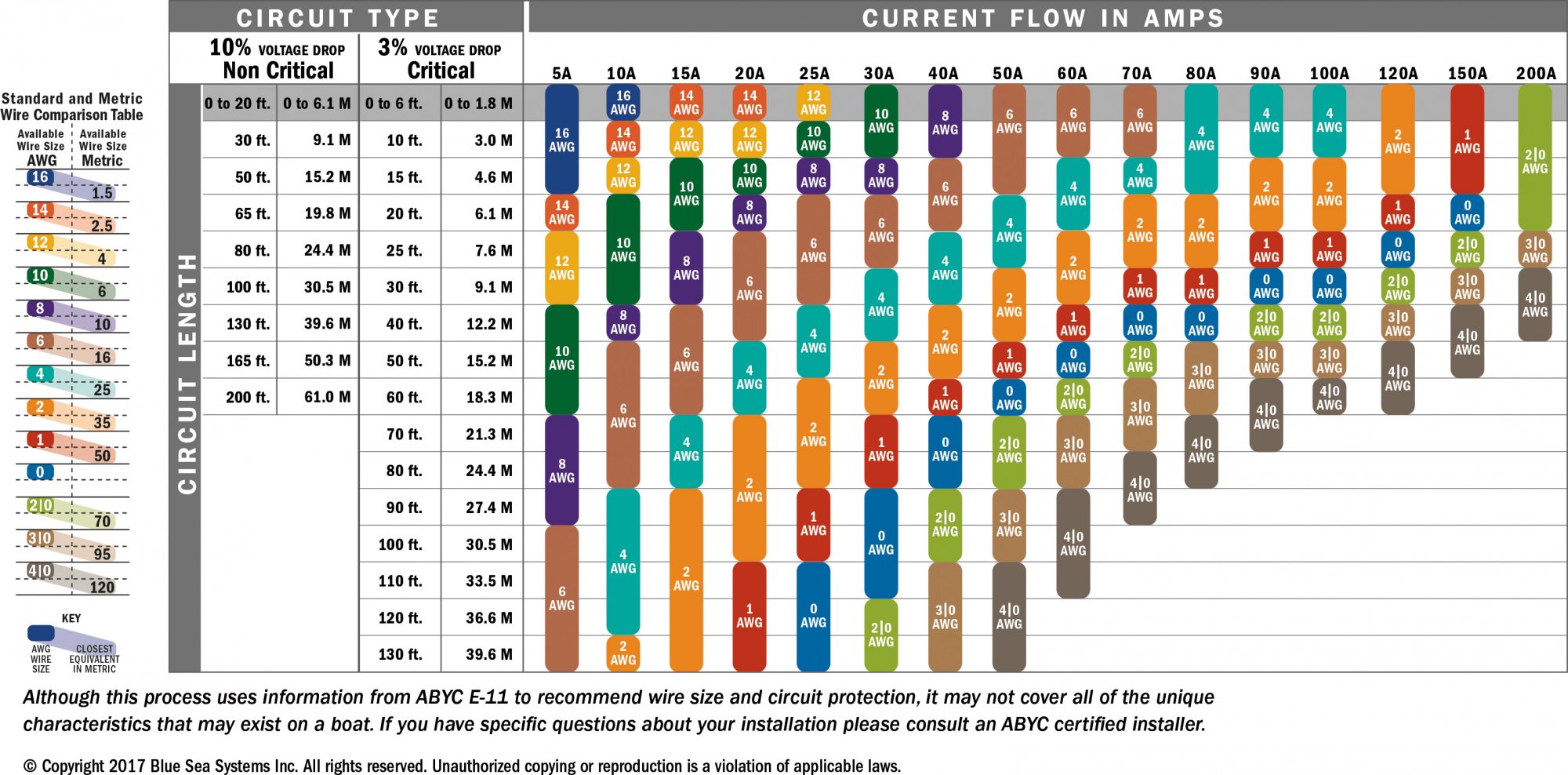

1 - anyone know the AWG of main battery connection cables offhand? I forgot to measure this weekend. As a first step toward electrical upgrades, want to install a battery monitor, uses a shunt on the main negative connection.

Noting that this is a "First step" toward an upgrade, just repeating the AWG sized wires may or may not be the best action plan.
Attached is a chart from BlueSea that identifies the cable length (to be measured from connection to connection and then doubled to get the total length for DC circuits) and the amperage for various cable sizes. Assuming this is in an engine space the cables need to me the minimum recommended temperature rating of 105ºC.
