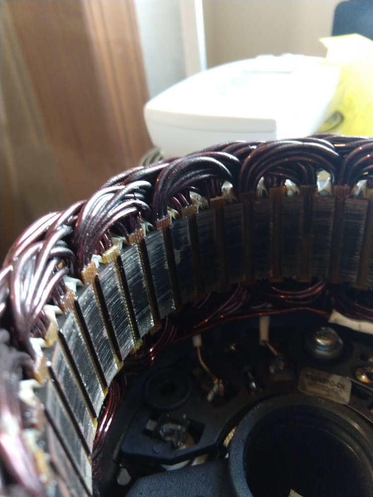

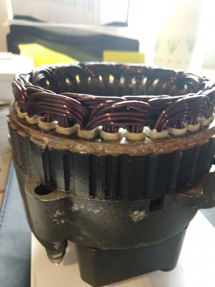

I have two strange engine issues I am hoping someone might have some insight on for our Universal M-25XPB. To give a little background, we have done some decent work to the engine over the last few months. This includes replacing the heat exchanger, raw water pump, freshwater pump, themostat, coolant flush, replacing the alternator, new dripless adapter, new cutlass bearing, checking the engine alignment, checking and painting the engine mounts, cleaning and painting the block along with the typical fluid, filter and belt changes.
Let's start with the alternator. Factory the boat comes with a 51 amp Motorola alternator. My factory alternator had failed 7-8 years ago, it had about 250 hours of use on it. I found the same part number cross referenced to the same alternator used on Mercruiser engines and could be bought for around $75. I didn't expect much from these cheap alternators but my first one lasted 5-6 years, about 600 hours of use. It failed while we were in the Bahamas, but I had bought another as a spare before we left to go cruising and just swapped it out. The spare lasted until about May of this year and then it died, so about 2-3 years, about 900 hours of use. I bought two more of these cheap ones and put one on. The first of this batch died this past weekend, so about 3 months, 50-60 hours of use. Nothing has changed that I am aware, but going through 2 alternators in 3 months has me a bit concerned.
Just a little background on my setup. I have a 4 AWG wire going from the output of the alternator to a service switch (Blue Sea Systems M-Series 6006) and then to the primary bank with an ANL fuse. The primary bank is four Trojan GC batteries in series and parallel for a 450 Ah bank. The bank was very low, about 55% SOC, when I started the engine and this last alternator blew after running for about 3 hours. Everything is working fine with the new alternator (the second from this batch of cheap ones) but I am probably going to go with a high output external regulated alternator before we leave STT to go cruising again. I want to make sure I'm not missing something that will damage a good, expensive alternator. I plan to take the blown alternator to a local shop to have them look at why it blew. So any suggestions on something I am missing or not checking?

I think you are burning up those alternators with that big house bank. A higher current capacity alternator is really just a higher thermal capacity alternator. Maybe the diodes burnt, maybe the windings burnt, who knows.

Pretty much what I think. Just looking for some confirmation of my opinion.

I am thinking you just had a defective alternator. I have about the same set up with batteries and have been using a replacement Mercruiser one after the original Mando failed a few years ago. But I don't put near the hours on that you do.

My read is that your best bet is to find an alternator repair shop and have them check them out.
I now have those two el cheapo alternators that were worked on by my old Oakland, CA guy and they remain serviceable. And working just fine.
I have also just finished LOGGING hourly amps and amp hours, last mini-cruise a week ago and this one, something I have ALWAYS known, but just decided to write it all down to CONFIRM what I thought I knew.
My load exceeds my input ability, but with SEM ON (i.e., full output) and at 1500 rpm , I can put back 30 ah in an hour. So, I run the engine for an hour every other day if I want to stay somewhere on the hook until I HAVE TO plug in somewhere.
But you know this stuff already. :)
You just need someone qualified to look at your alternator(s).
I think you're just fine. The case is always OK (usually) and just the bearings and diodes need to be looked at.

Same as ours was before Maine Sail fixed it. Little alternator couldn't stand the heat and stress of charging the big bank. New battery alternator, regulator, and drive belts got the charging in control then the tach started working again.
