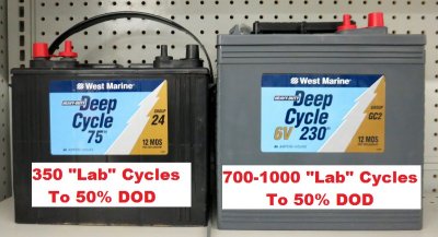

This article is more general about buying deep cycle batteries:
What Is A Deep Cycle Battery?

Great battery article. What if I don't have the height available (currently 3 pseudo group 27 'deep cycles' with about 1/2 inch of clearance above)? Without modifications what are the best options?
Feb 6, 1998
11,759
There are a few ways you can go.
#1 Accept your limitations and stick with a premium quality pseudo battery and replace it when it dies. If you practice good battery care you may be able to eek out another 6 months to a year beyond where you are now. Cost is minimal, no mods. Upgrade cost = $
#2 Move to a premium AGM (Lifeline, Odyssey, Northstar) or GEL (Deka, Trojan or Sonnenschein/Prevailer) battery. In the G-24, 27, 31 4D & 8D both premium AGM and GEL are deep cycle. AGM's & GEL's are arguably a bit temperamental in how they are cared for and charged and these really need to be installed as a "system". The charging system upgrade costs can far exceed the cost of the batteries. These batteries are simply too expesnsive to not install correctly. Done correctly AGM can often approach 6V GC2 life and GEL's often exceed it. You can murder expensive AGM's & GEL's just as fast as pseudo batteries if not done right. GEL batteries are really the hands down kings of small case cycle life. The Deka GEL is rated at 1000 cycles and I have a number of banks out there well beyond ten years and one into its 15th season. My buddy Bruce went around the world TWICE in the same set of GEL batteries..... Upgrade cost = $$$$$
#3 Relocate your house batteries and fabricate / build a new space for them. You can leave the starting battery a deep cycle pseudo type, in that location, and just revamp the house bank. Upgrade cost = $$$
Some times when you factor in how long you plan to keep the boat, sticking with pseudo batteries actually wins.
