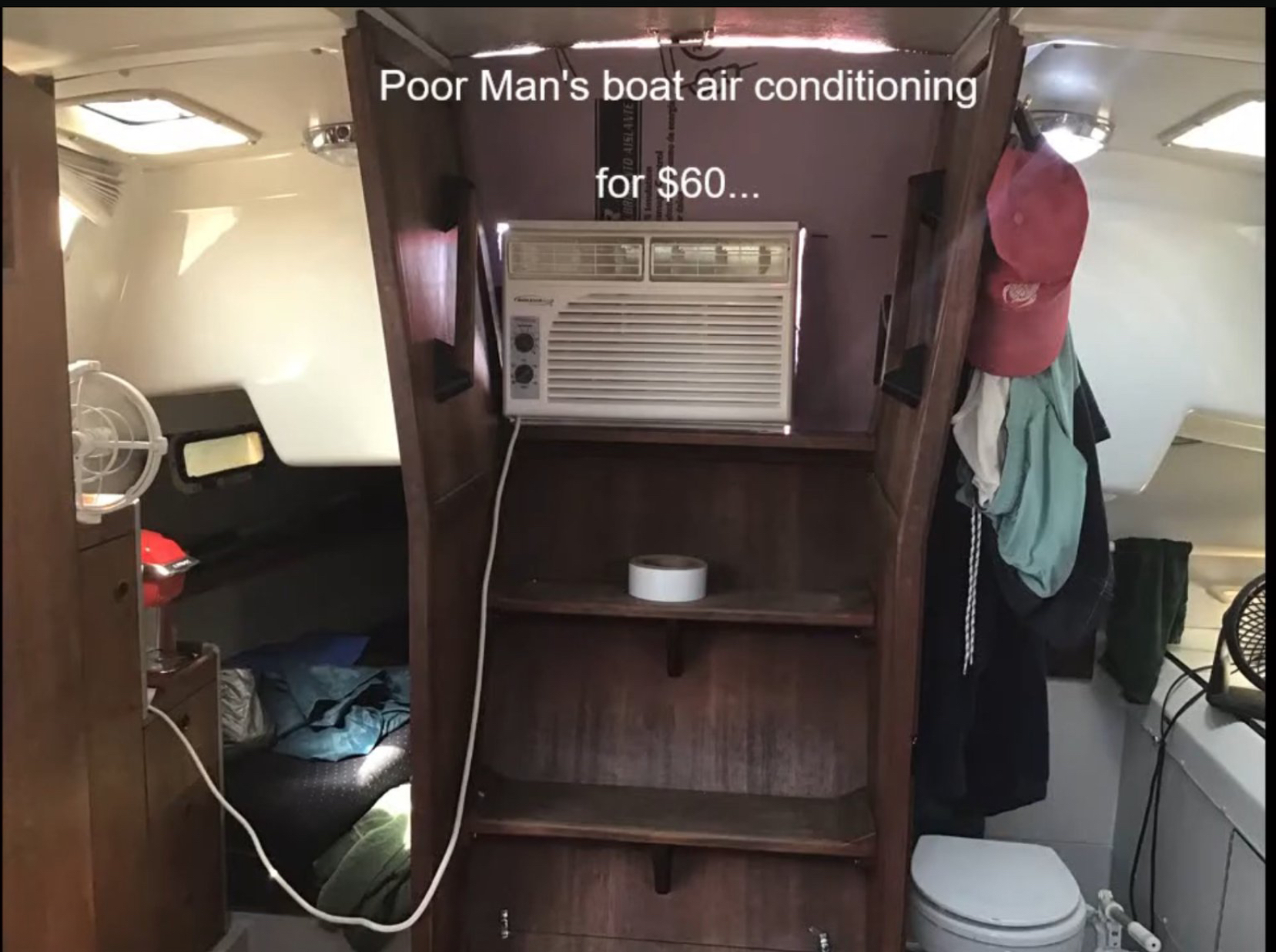

I tried a window unit at first, mounted in my companionway and surrounded with some foam board to block out the warm air. It was a 5000 btu unit. I ran it off shore power only. Condensation dripped in the cockpit and out as upper drain. But it didn’t really keep my boat very cool. I have a 32 foot O’Day 322, so a bit more to cool than your 25. It also had to be removed when sailing and I had to climb over it when it was in place at the marina.
Last year, I bought one of those free-standing units with the hose to push the hot air out of the boat. It was 8,000 BTU. It drains into my bilge. The biggest issue with this unit is the size and where to run the exhaust hose. And the thin vinyl hose itself puts off a lot of heat. I found a place for it, routed the house out of a portlight that opens to my cockpit, and then insulated the hose with Reflexite. Made it more efficient and made staying at the dock almost tolerable. Except the thing blocked access to the rear berth.
