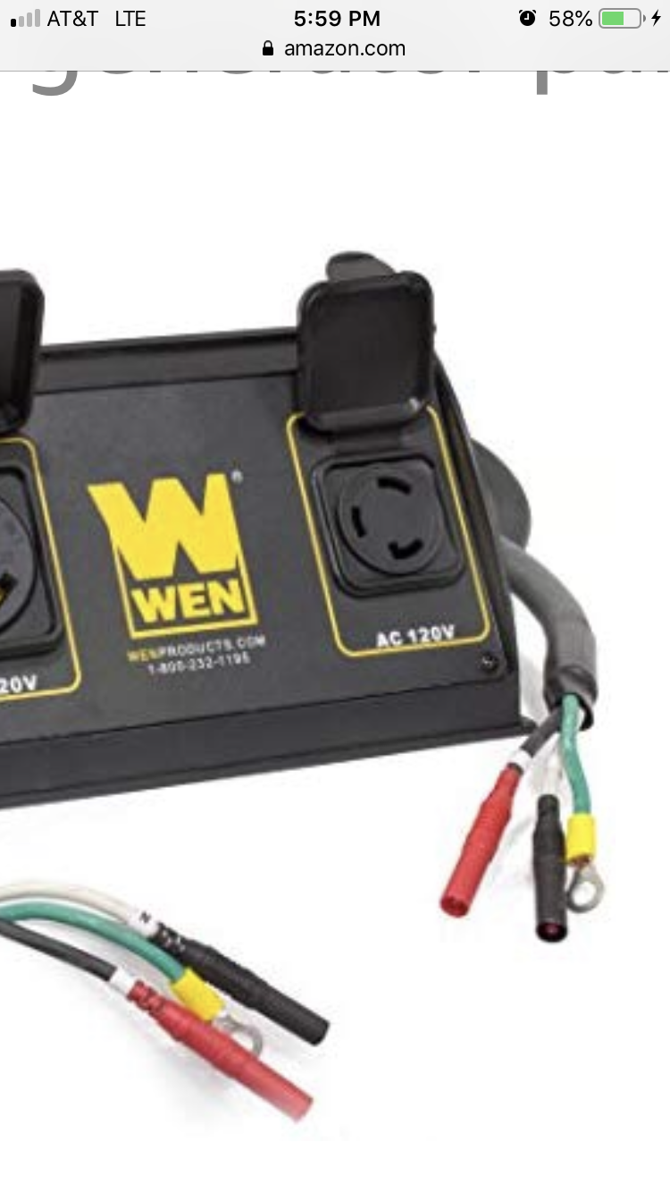

Ooh! That’s promising. I might start with one and check out the inverter. It is lithium batteries with a zantrex 5000 watt. 590 solar. Here a pic of what I was looking at for a parallel going to a 30 amp shore power chord.

This is what I ordered off amazon. I should be able to connect the 30 amp for the ac and zantrex. The 50 amp shore power is being used at the dock right now. I’ll store the 50 amp cable and buy a short 30 amp cable for generators to boat use at my mooring. If possible, I’ll use a longer 30 amp chord if I’m ever in a temporary slip. That will be rare to get on Maui plus the state wants too much money a month.

I still haven’t picked up the boat. The money transfers took longer than expected. I did get the wen combiner unit and picked up another Honda 2000. I have a 30 amp shorepower chord now too. It’s currently hooked up with the 50 amp. So in my mind, I’ll fire both Honda’s up and plug in the shorepower to the 30 female on the boat. I will put the 50 amp chord in storage. I haven’t looked yet to see if the 30 amp receptacle is hooked Up to anything. I’m hoping Catalina has it set up that you can use 30 or 50 at any time? I’m not sure if any previous owners have rewired anything. The 30 amp receptacle should go strait to the zantrex 3000 watt only correct? Or to the nav station first to shorepower switch and then the zantrex charger/ inverter. It’s been frustrating not having the boat on Maui where she will live starting Friday or Saturday from Oahu.
