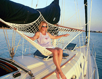

Wondering if anyone has hung two hammocks between forestay and mast. One persons feels like a lot of weight, but she and I are only about 350 put together, we're wondering if hanging two hammocks side by side would be too much stress on the forestay. Anyone done this and comfortable with it?

A 225 pound member of the Mariner Class Association hangs a hammock under the boom of his Mariner supported by a topping lift. I would expect a forestay cable to be adequate, but the forces, without a spar to support the stay, will be in a different direction. You'll be putting a perpendicular vector into the direct tension line. This increases the overall tension as well.

I think the issue is will a hammock attachment line wrapped around the furled head sail damage the furler, sail or forestay with 350lbs suspended from it?
I do not think so, if the wrap is a wide strap and the pressure on the sail/furler is spread over the wrap and not concentrated so that it can bend or collapse the furler extension. The mast is is fine.

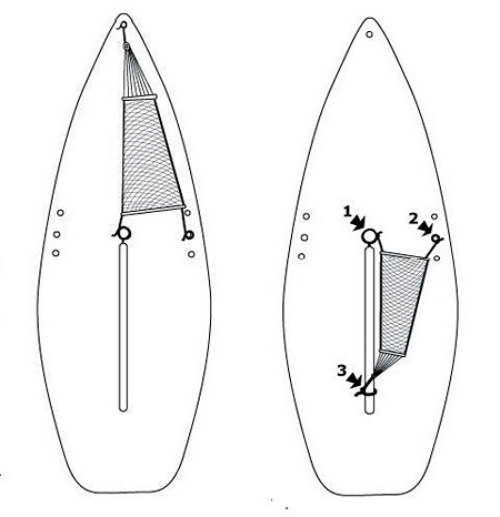

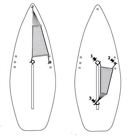

What about securing one end on the mast, and the other end at the end of the boom? Assuming you have a topping lift, I would think that would work (if the boom was long enough).
To the OP, I think 2 just doubles the weight and concern about damaging the furler extrusion.

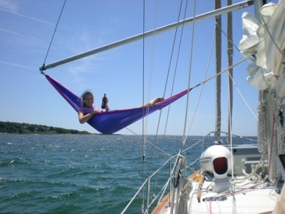

Friend of mine hangs a couple of lounge chairs off his jib pole suspended between the forestay and mast.
