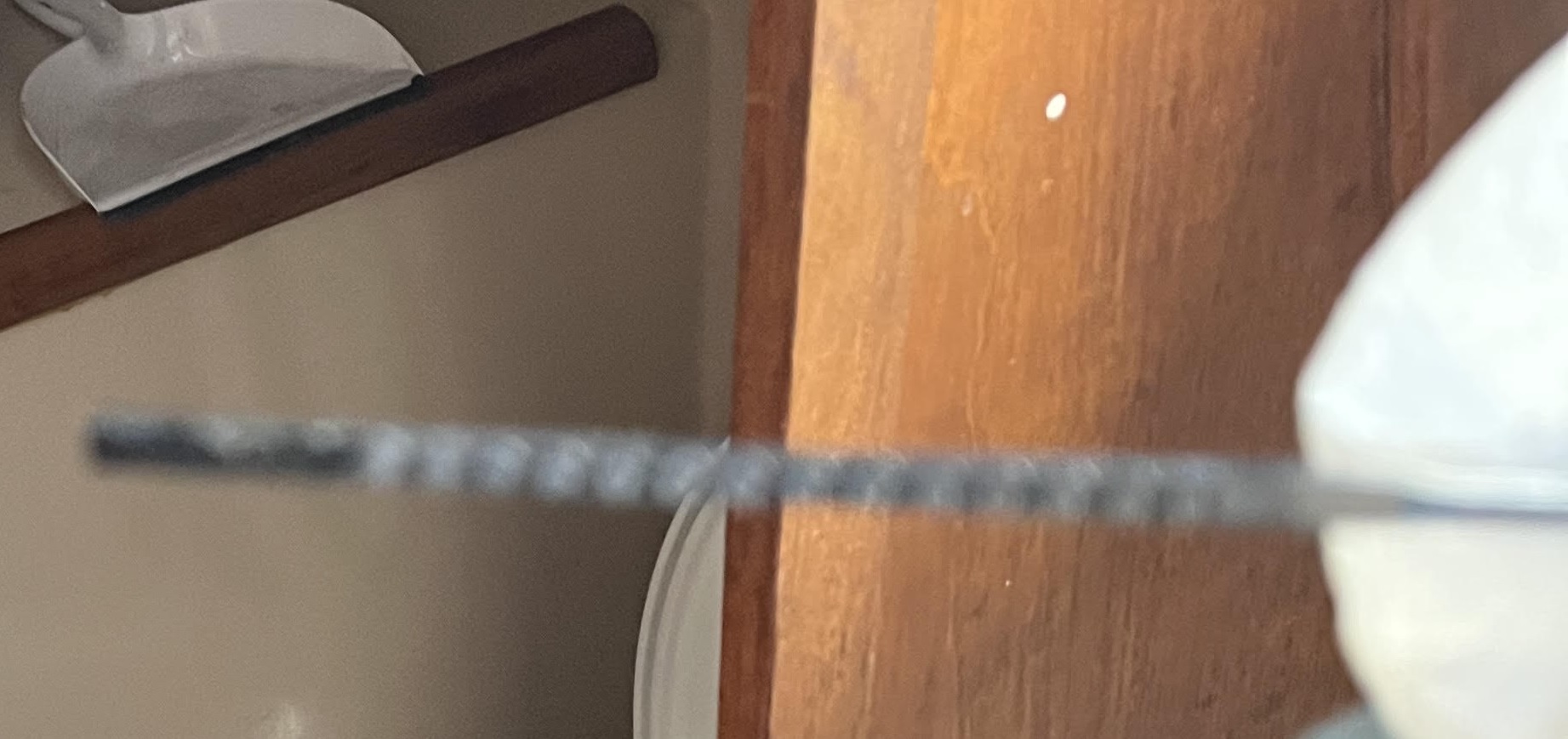

Next, I got a thin funnel and added the next quart of oil directly into the upper dip stick hole. I took a pic of the level, which is attached. I then ran the motor for about twenty minutes with an oil pressure of around 35 and no alarms and no apparent leaks.
Here is my question. There is no calibration for "full" or "add" on the dipstick. How do I know when it is full, and am I right to ignore the lower dipstick? I have read posts where people have gotten inconsistent readings from the same dip stick on their diesels. Is this possible?

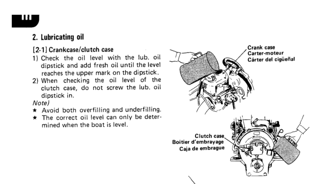

The SB12 manual at http://www.varen4u.nl/pdfs/yanmar/SB8_SB12.pdf does seem to say there are separate ports for adding crank case and transmission oil, so that’s probably what you’re seeing. The manual isn’t clear on dipstick location, so no help there. It also looks like the transmission takes the same type of oil as the engine, so it’s not like you did damage by mixing oil with transmission fluid.

:plus: What @Davidasailor26 says. Manuals can be so helpful. Great to read in the evening this time of year. I get images of engine parts, dancing in my head.
Do the images here show the two dip sticks you found on the Engine?
They call the lower one the clutch case and the upper the Crankcase. They are showing the fill locations. The dip sticks are usually located nearby. Sometimes the clutch case fill has the dip stick in the fill cap.

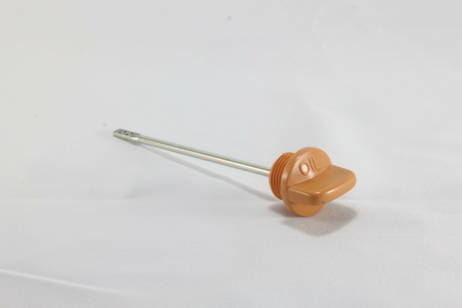

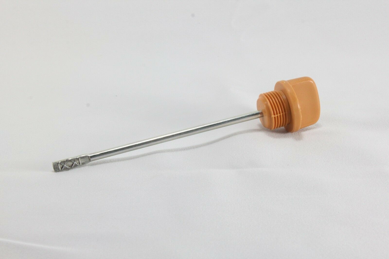

''I doubt the lower cap with the dipstick is original. It is bright yellow plastic and it reads "oil" on one side and has characters which appear to be Hanzi on the other.''
FYI, if you google Yanmar SB12 diptick and then click on images, you'll get a lot of pictures of different dipsticks, one of which is very similar to what you describe as the lower cap.

Thanks everybody! Upon further examination, I think there are three dipsticks on my boat: One for the motor, one for the transmission, and one is me. I am the third dipstick! I tried to fill my crankcase by putting SAE30 into my transmission. Luckily, my transmission uses 30 weight oil. In my own defense, I had never heard of a transmission with an oil cap that reads "oil".
I checked my clutch dipstick (the one Claude L.-Auger posted a pic of) and the oil level is about an inch above full. I purchased a dipstick oil change pump and plan to remove the excess. The oil is so clean I had to try several times to even see the level. I will use a paper towel next time.

The only real question I have left is where is the full level on the crankcase dipstick and the clutch dipstick (I posted a pic). At this point, I have added two quarts of oil and the level is not quite in the middle. If the level should be at the upper end, I will keep adding oil. I am just not sure of how much...
