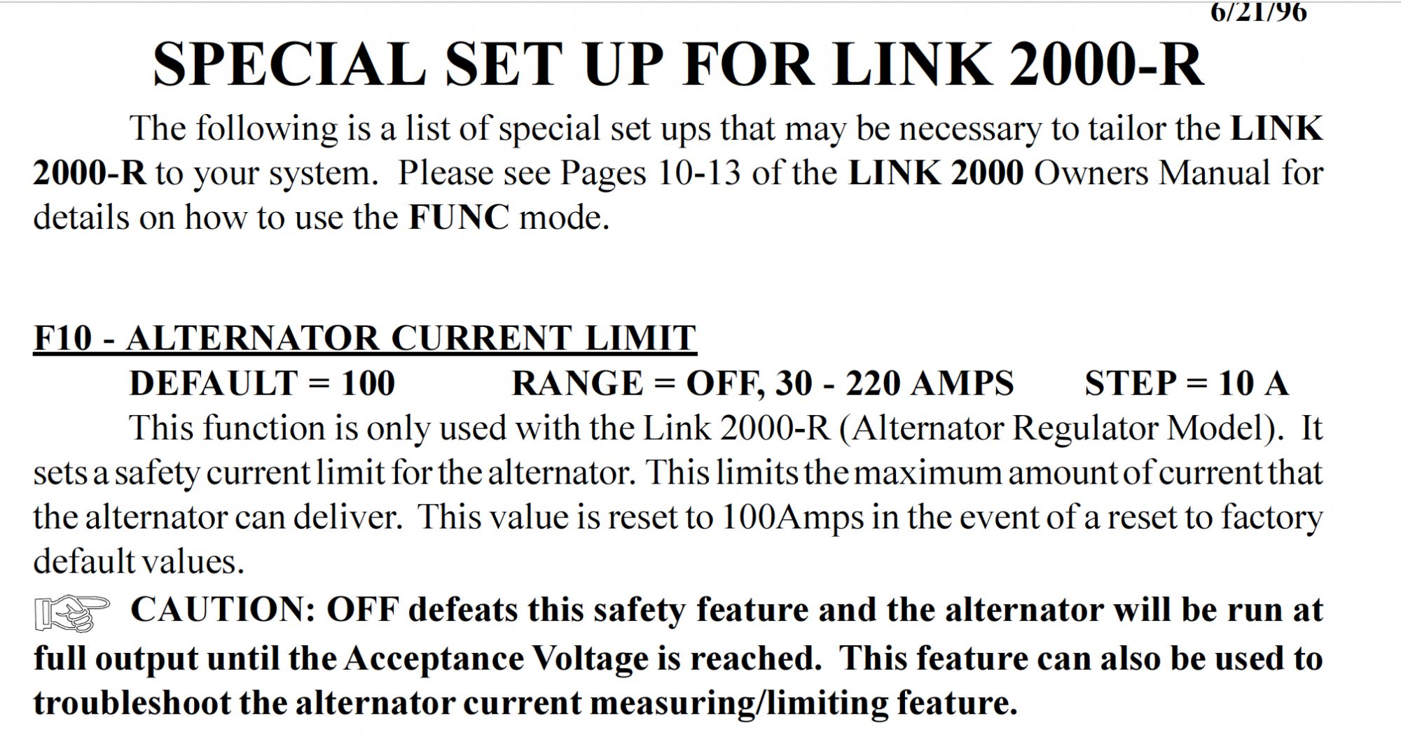

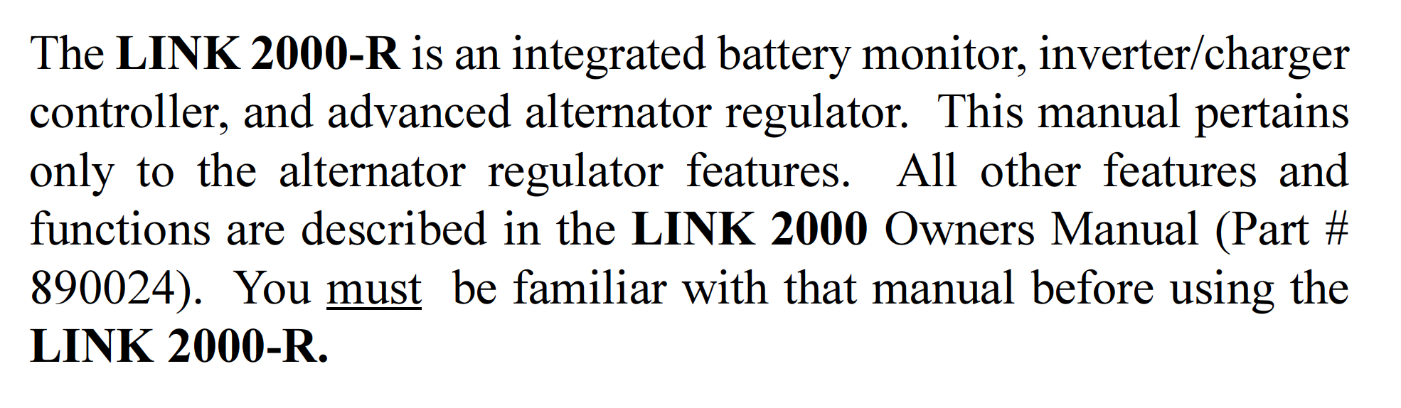

I don't really know if it's a Freedom 10 or 20, I'm a bit confused about that now. But, regardless of that, I'm talking about limiting the charge current from the alternator, which is done via the user interface of the Link 2000-R. And, yes, you can limit it, and it does work. So maybe it's not so much a Freedom 20 thing as a Xantrex regulator and Link 2000-R thing.
From the Link 2000-R manual, circa 1996, page 1:
and page 7:
