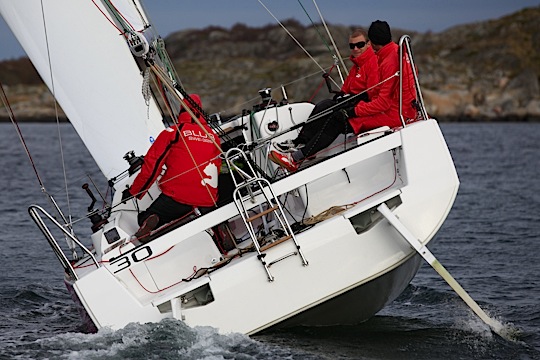

They are pretty much bore-sighted down the centerline. They are canted OUTWARDS however, so when at optimal heeling angle the leeward rudder is vertical in the water. This aids steering greatly because the rudder is just turning, and not trying to lift or 'dive' the boat. This is the big reason why they are more stable, and why single rudder boats spin-out when heeled hard over.
They do however need to be in alignment. The only way permanently mounted rudders can come out of alignment is of the tiebar slips.
