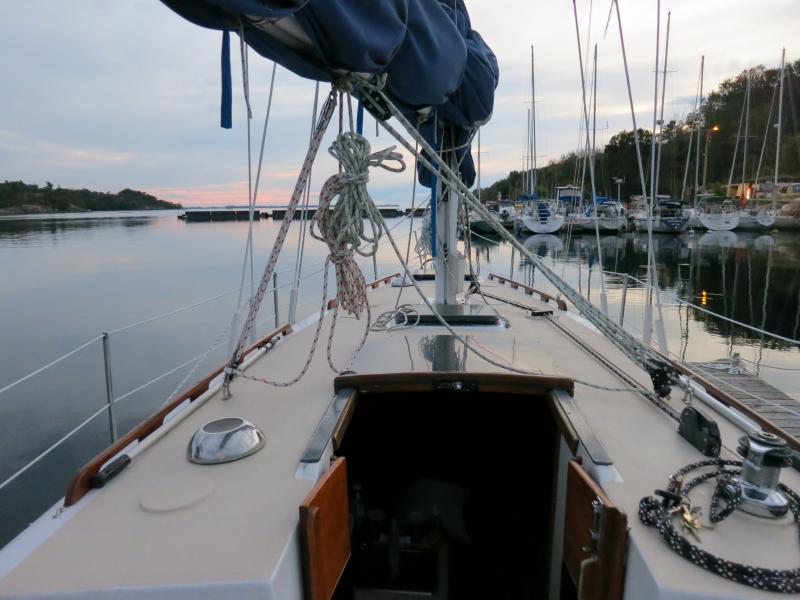

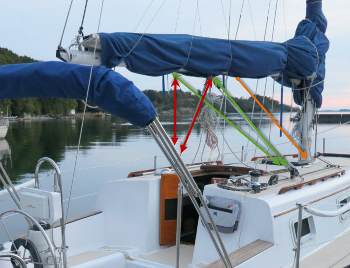

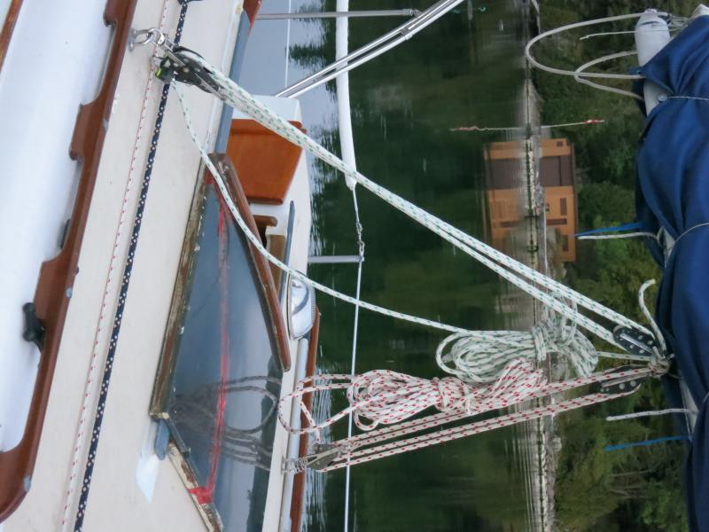

I didn't like the traveler location on my H33C.
Here are some photos of my new set up with twin main sheets.
It works very well and was much cheaper than mounting a cabin top traveler.
Someone will comment on the red tape holding the hatch together. It had a 4 inch cracked when I bought the boat and it finally broke in August. That's now another winter project.

They are not deck eyes but u-bolts. The u-bolts are going through the cabin top and have a backing plate. I removed the liner with a 3 inch hole saw and since the liner isn't structural on these Hunters, I filled the gap and pushed as much thickened epoxy between the liner and the core. It's solid.
As for adjusting the boom, it feels like I have a better control on the main shape. It also helps when going down wind.

There are several advantages that come to mind.
No need for expensive traveler.
No head banging obstruction across companion way.
No need for boom vang.
Acts as a preventer eliminating accidental gybes.
Better visibility forward without traveler in way.
Disadvantage:
Two sheets to adjust. (but then you don't have to have the traveler to adjust.)
At any rate I would like to try it before passing judgement on it.

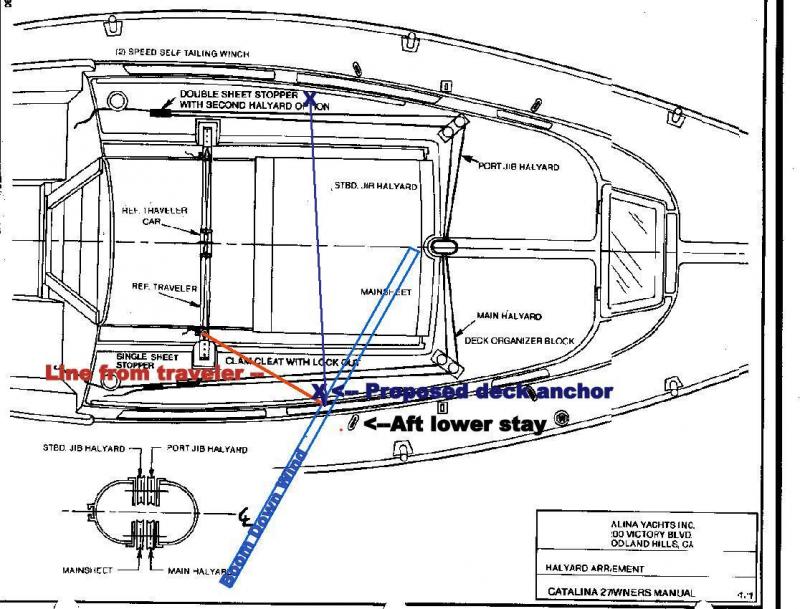

23,401
Except that you are tigjhtenning up the lee side when the boom swings over and pulling straight down with the sheet. The windward side is the one you are loosening.
Frank, when the leeward mainsheet is let out, say on a beam reach or beyond, the leeward mainsheet is NOT in a position to pull the boom DOWN. That's why you still need a vang. again, think about it, some more.:):):)
Stu, ok, ok I gave it some more thought. I think the picture is self explanatory.
Nov 8, 2010
11,386
Frank,
If the scale and location of the diagram are correct, then you are right, you might not need a vang. But I think your boom is at risk... that is an amazing amount of leverage/load on the boom, with the mainsheet begin so far from the clew.
caguy
Sep 22, 2006
4,004
No different than the bale location with a traveler. That's why booms break with travelers on accidental gybes. I've always assumed that is the reason for multiple bales and blocks on the boom, to distribute the load.
Nov 8, 2010
11,386
Measure the lengths on the diagram.
If the diagram is correct, its closer.
If the diagram is not correct, he needs a vang.
You are right about the multi-bales. It helps a point failure, but not if the boom is totally loaded up with a huge span between the clew and the sheet. All else being equal the farther you move the traveler towards the clew, the better the sheeting will be.
