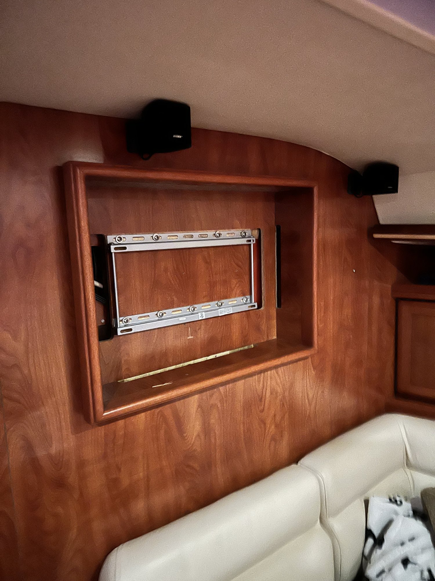

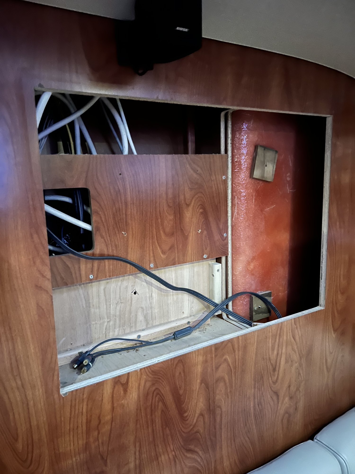

So just as an update, after many 4 letter words, I got the tv off the bulkhead. I had found the access panel behind the locker before, however I was expecting access to the TV Mount. As it turns out, it’s only 4 screws holding in a “box” and it pulls out as a complete unit. Thanks for everyone’s input and if anyone else needs I have pictures to help.

Those are the only ones I had on my phone. If you look closely at the second picture, you can see 4 holes, which held the Philips screws. Those screws are accessed from the locker in the forward cabin. As mentioned above you need to remove the bar and a small cover plate. I’ll keep checking so if you have any more questions let me know.
Also, if you want to remove the tv from the “box” you need a screwdriver bit called “torx”. Like an Allen key but with a hole in it.

Thank you very much for posting your pictures. I have a 41DS, I will be moving my TV to the port side of the doorway to the forward cabin. There is an alcove on the other side of bulkhead in the forward cabin that does get used. So I won't be able to recess it into the bulkhead. Of course the little existing TV on the starboard side of the cabin door isn't recessed now. I'll have to research the thinnest TV I can get plus a mount to see how far off the bulkhead it will stick out.
