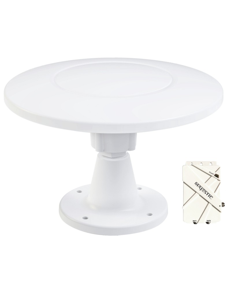

  • Majestic UFO X: rated @ 60 mile High-gain (30 dB) dome for fringe signals;

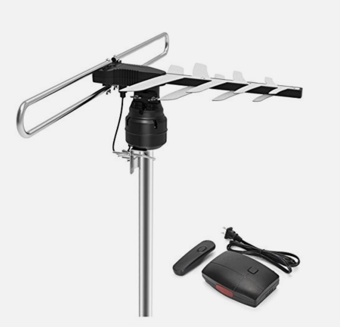

  • 1byone Amplified Marine: rated at 50 miles plus. Affordable flat-mount with 360° horizontal reception; low-profile for sailboats;
I have no experience with either of them. There specifications appear to be in line with your assumed needs.

I have a Majestic UFO X antenna about 52' off the water on my mast. It does a good job for stations that are 15-40 miles away. The distance is over both land and water.

The Majestic and others are all powered, but the power required is small - their spec claims 100mA. The power flows up the antenna cable, so installation is very easy. You could hoist the antenna when needed, perhaps from a spreader so that it doesn't bang on the mast.
