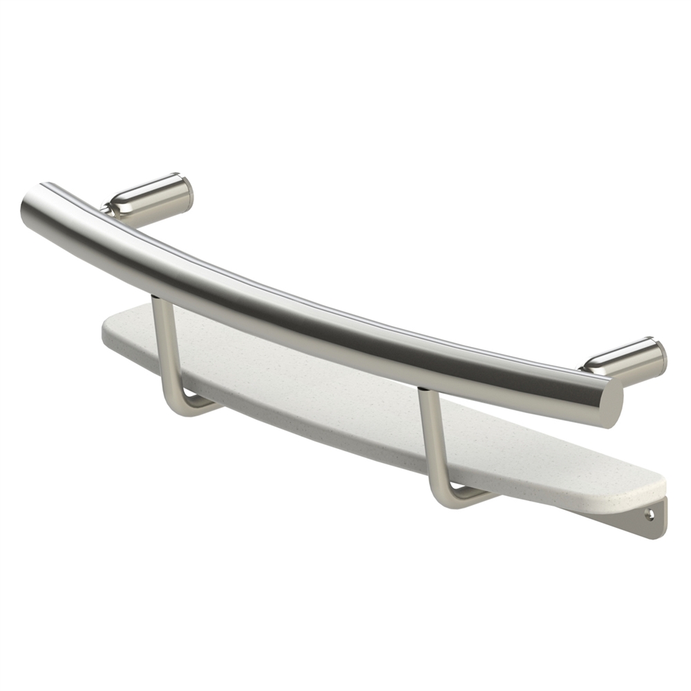

Bolt it with acorn nuts on washers in the head side. I like to make dual-use things whenever possible, so maybe put a towel hook or bar under that nut?
