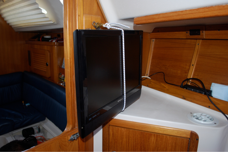

We have a flat screen mounted on a swing arm (not the original swing arm but in that same location). You can swing it to view from the berth or the salon. We look it down with a bungee cord when we go sailing.
This is similar to the bracket we have. http://www.amazon.com/VideoSecu-Art...TF8&qid=1397150678&sr=8-6&keywords=tv+bracket It's through bolted on the bulkhead and is very secure.

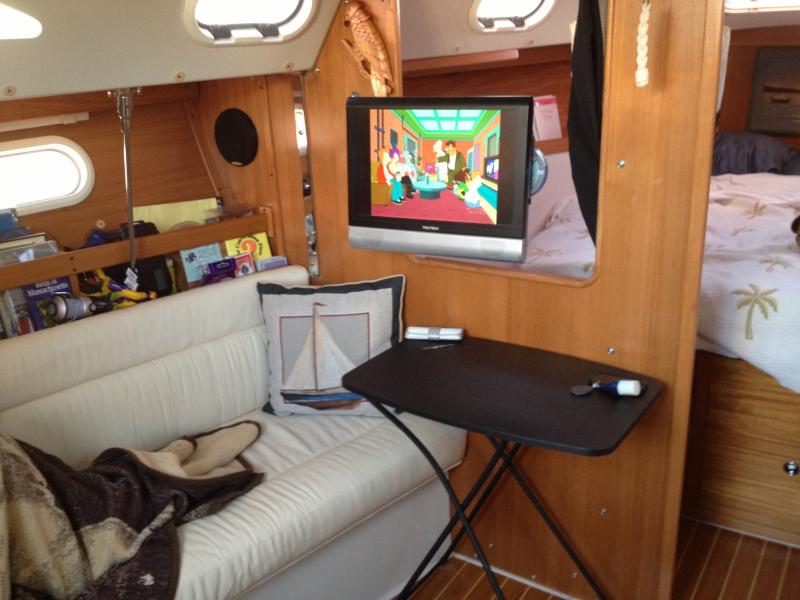

Happy to report that the conversion from the old analog TV to a digital TV was without incident. This is truly one of the few projects (boat or otherwise) that was straight forward. Replaced original TV with a 22" RCA Hd flat screen 110v with built in DVD that plugs directly into the inverter. Replaced the original swing arm with a bulkhead mounted flat screen swing arm with a 14" swing. The 14" inch swing was important so the TV would be centered in the opening between V-berth and main salon.

Attached are 2 photos (I hope) taken with my iphone. Hope they are helpful. As an observation, the dememsions of the swing arm and the old analog TV -vs- the newer flat screen digital HD TV and accompanying flat screen swing arm, the new installation seems to "open up" the V-berth area quite a bit. In any event, if you have a use for the old style it is your for the shipping.

The pictures of the mount are useful. It really does open up the V berth. I may give this a try. Thanks.
