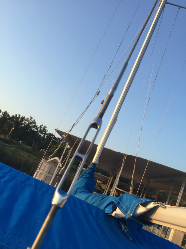

So after our boat was delivered we were doing lots of cleaning, looking around and checking things out. One of the things that looked "not right" was the backstay turnbuckle. How much "turn" (not sure what to call the metal pieces that screw into it) should be inside the thing. It seemed that there wasn't much at all actually screwed in. I mean maybe just the top of the "screw" was into the turnbuckle both on the top and bottom. Is this ok? (Picture the turnbuckle and being able to see 90% through it.)

So this is all I have
I am sure that's not enough. I'm so upset at the guy who commissioned my boat. Pretty sure the roller fuller jib is twisted too.
WOW you really need to do something before you loose the connection get the double jaw toggle and some cotter pins and get that fixed today before you go out again oh and for now take a halyard and tie it off to a cleat and secure it tight on the other end to act as a temporary safety while repairing this

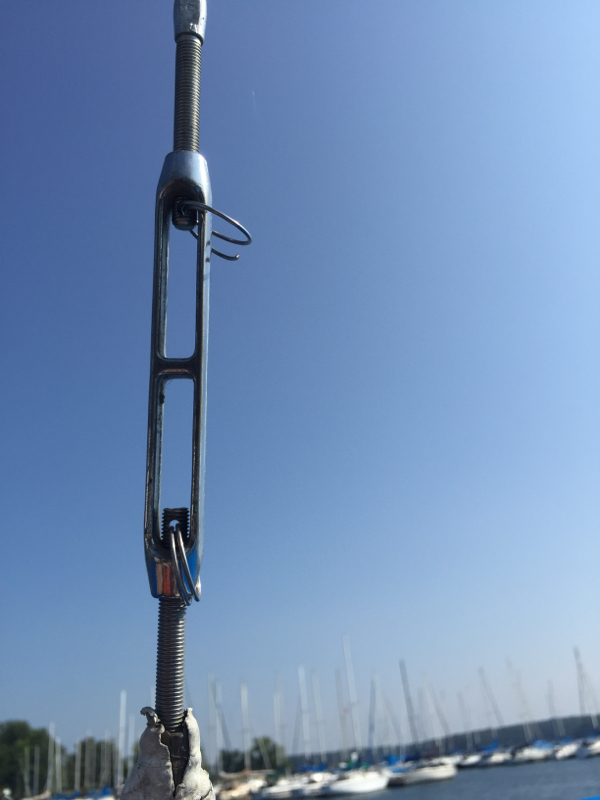

Holy cow - you need to get some more turns on that. It's barely enough threads to hold on. Looks like the rigger forgot to put some turns on and clearly forgot the cotter pins.

have you got any slack or sag in the back stay ...if so tighten up the turnbuckle more and put some cotter pins in until you can get the rigging adjusted correctly and if you paid the rigger with a check ...stop payment and notify him he will be paid when the job is done right
I feel much better now.
Thanks you guys.

Glad you got the backstay turnbuckle fixed. Did you make sure the roller furler and headstay are properly installed and not twisted ? If twisted it could have an impact on the positioning of the masthead towards the front of the boat hence making the backstay hard to secure properly.
