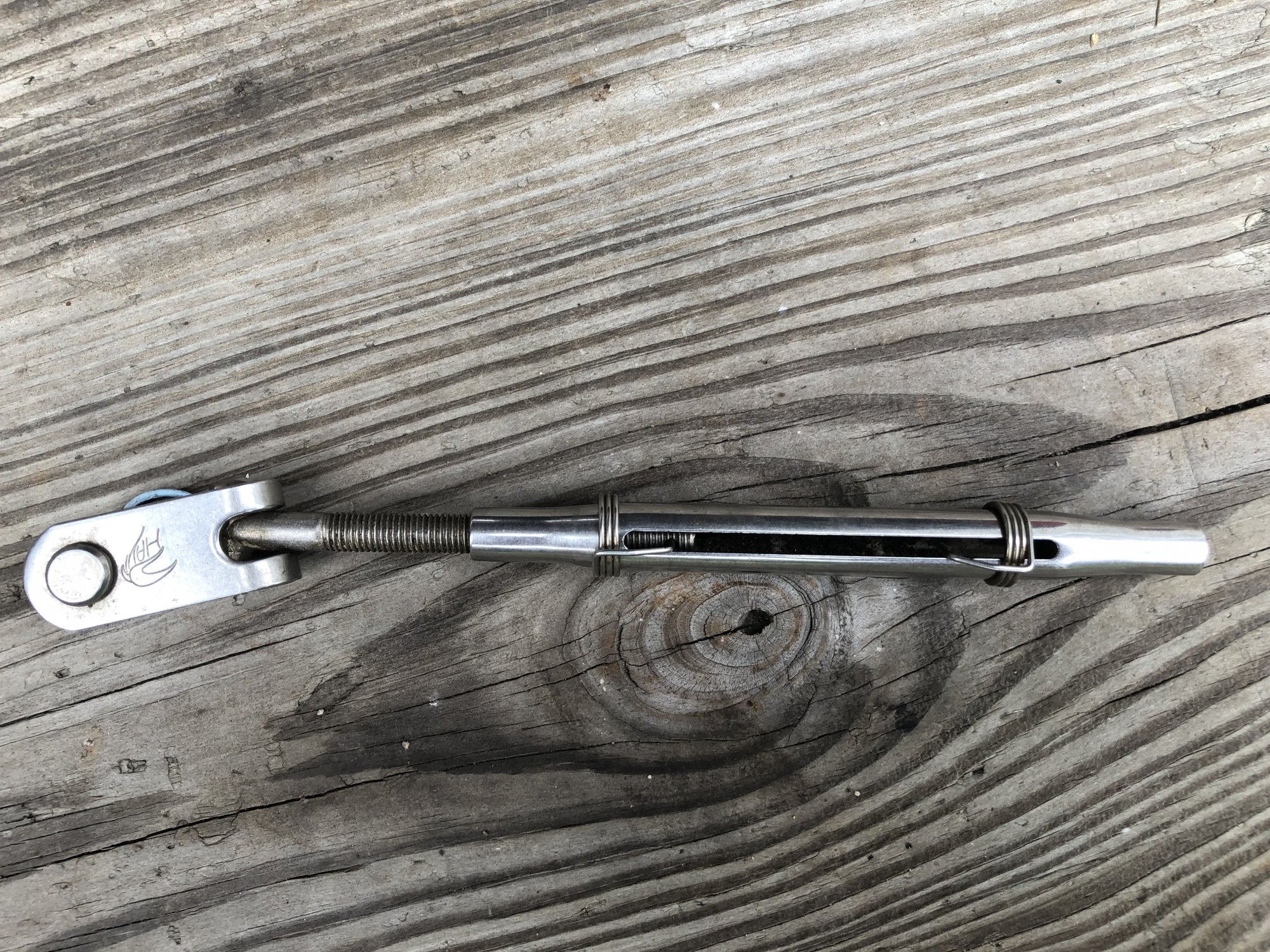

Anybody know where I can source the springy-looking turnbuckle locks in the photo? I have an older daysailer and the closed barrel turnbuckles are missing these. They make adjusting and locking the turnbuckles a breeze. I don't want to use jam nuts or safety wire.

Go to your favorite local or online boat chandlery OR sailboat rigging supplier like West Marine, Seco South, etc. to purchase a replacement.

Need to go to a West Marine store that has an onsite rigger. The rigger will know. We have one in Alameda, CA and that is where I go for rigging parts questions.
24,474
Might also go to a hardware store to get some stiff welding wire or tape wire. Create the same wrap, or run a single wire between the two holes and bend the wire to insert into the holes. Simple and clean.
Not quite the same design, but we've been happy with velcro-wrap "scar pins" for the same purpose.
E.g. Cotter Pin Wraps, 1/4"

The Cotter Pin wraps are more than just velcro covering the pins. There is a short piece of SS rod attached to the velcro, the rod is inserted into the turnbuckle stud and the velcro holds it in place. The also come in a larger ⅛" diameter pin size.
The one down side is the the expense. In the larger size they are about $15 a pair. On my boat I need 8 pairs. Ouch.
To soften the blow I buy a pair or two when I have another order from Defender on the way.

I made my own. Used double sided velcro and put a ss rivet about midways in the 5" x 1" velcro.
Another good idea. Was thinking of continuing to use cotter pins and simply covering them with the velcro instead of tape.

How many years can you get out of these? Velcro, even UV protected types, still lose it’s sticking abilities over time and use.
I have had mine on since 2012. No problems. Boat deck and turnbuckle areas covered Oct-Apr for the winter but other than that exposed to the elements.

Stainless steel cotter pins for trailer sailboats. If using them make sure ends tucked into turnbuckle body. I would suggest the use of turnbuckle boot covers or tape over the turnbuckle body to make sure the ends of cotter pins cannot catch on anything

I kept a small spool of stainless steel wire aboard. Thread a piece of the wire through the hole in the threaded rod, take a couple of wraps around the turnbuckle body and you’re done.
