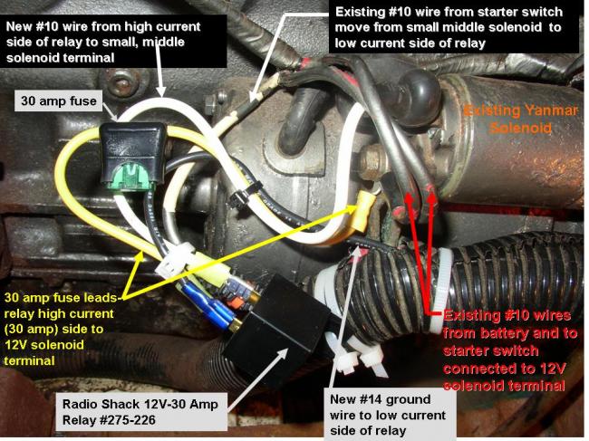

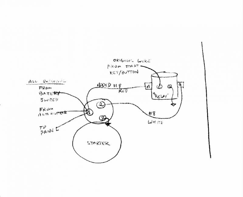

If you get intermittent starting, I can't see how the fuse could be the problem. The fuse is either blown or it is not. I also don't understand why you dismiss the "Hunter Harness" as not being the issue. To me, your problem starting sounds like the classic case of the solenoid not getting the needed volts/amps to crank the starter. I've written a lot on this issue and it is available in the SBO Knowledgebase under Yanmar engines. When I had this exact same problem many years ago, I fixed with by adding a simple 12vdc relay (with a 30 amp ATO fuse in the line) to the solenoid. Never had a starting problem since.
