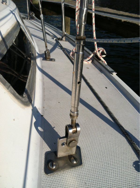

Attempted to tune the rigging on my '81 Catalina 30 tall rig. The owners manual says the lowers should be looser than the uppers- which should be tight. The forward lowes (it has 2 lowers per side, one going forward one going back) were extremely tight. I was wondering whether the wind on the bow would cause that or whether they were truly too tight. Seems I most likely need to loosen them. But. I have no idea how to. They dont have the standard turnbuckles. Heres a pic. Any idea how to loosen these?

Those are so-called bottle turnbuckles. At each end of the center body, is a lock nut that you loosen, then turn the body just like any turnbuckle. Cinch the lock nuts back down to prevent the turnbuckle loosening again. You could stick an awl through the hole in the body to assist in turning it.

Be sure to hold the "flats" on the shroud above the threaded portion. Otherwise the cable will twist and return at least part way to where it started. A wrench for the flats and one for the jam nuts, then the awl (or there is a specific tool for the round area with the hole). Count the turns or half turns you use to loosen the shrouds so you can keep them even or return to the original tightness.
Boat flat on stands (or better yet, in the water) to do the adjustment. As little wind as possible is good too!

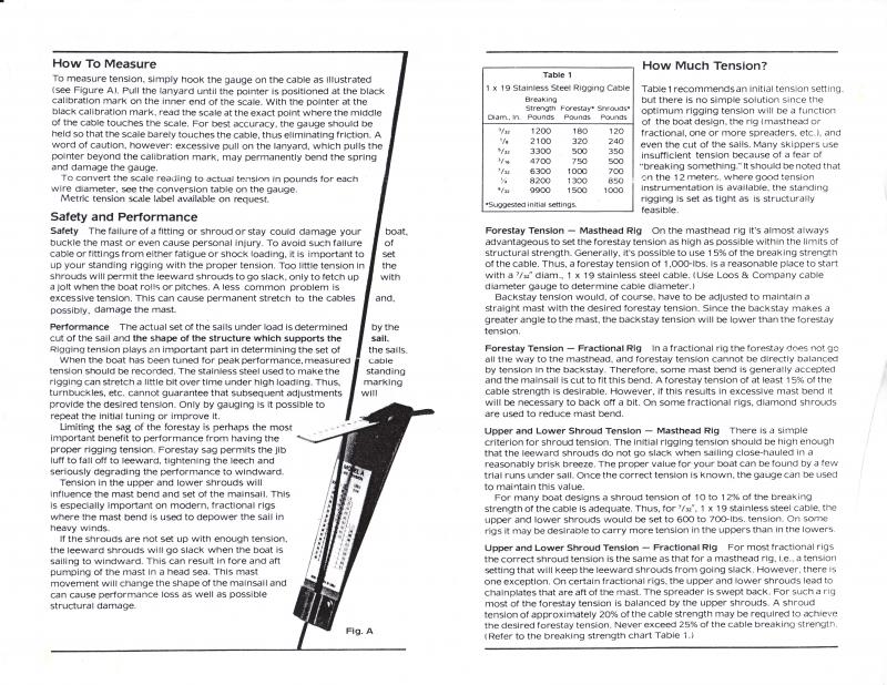

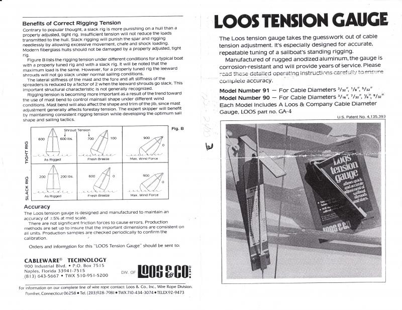

Here's the orig. C30 manual, it has some useful info on tuning.
Also, here's my Loos tensioner specs for a starting point for tuning.
You should start out with the values in Table 1 as a starting point.
