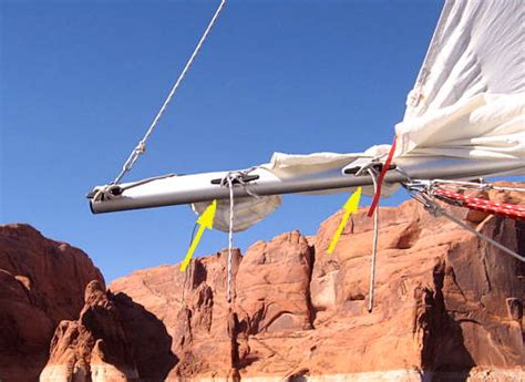

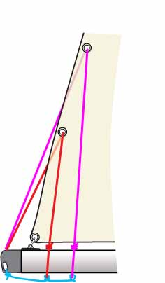

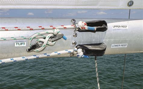

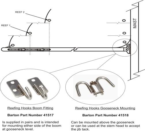

Ideas for you.
Reefing from at the mast is not a bad idea. It is a personal choice. I set my reefing at the mast. All accomplished on the port side.
First you lower the sail by releasing the halyard and either tie the tack reefpoint to the goose neck or hook the sails reef tack around the reef hook.
Then you tie down the clew reef point to the boom. If you have a line running up to the reef point and back to the boom you pull the reef point tightly o the boom.
C1BED93E-0FC3-42F0-9CC3-CDF3392FEBBB.jpeg 287BD7CF-4E7E-4688-9CE6-A529FCA26D6C.jpeg DDACADC2-0399-4103-A692-30BCBE7E98C9.jpeg 6EAF26A8-C6DA-43F5-8E35-C76207507EB6.jpeg
Now you are ready to raise the main up tightening the luff.
Finally you can gather the loose foot of the sail snugging the loose foot up to the reef tie points along the reefed sail. Do not ties the sail to the boom. The reefing points are not reinforced and this will create the possibuuty to rip the sail. The only reinforced points are the reef tack and the reef clew.
