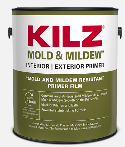

I’ve done this on a MacGregor 22. It’s a bit of a pain, but it works. Remove anything you don’t want damaged, then go inside with a pressure washer in one hand and a shop vac in the other. Add some Pine-Sol to the washer’s soap reservoir and clean everything thoroughly, then follow up with a fresh‑water rinse.
Next, set up a few fans and let the boat dry for several days. After that, close it up and run an ozone generator inside for a few more days (an example is available from Home Depot).
At that point, the boat will smell great—and honestly, that’s where I should have stopped—but I went one step further and painted all exposed fiberglass surfaces with…
The boat smelled VERY fresh ... even three years later when I sold it.
