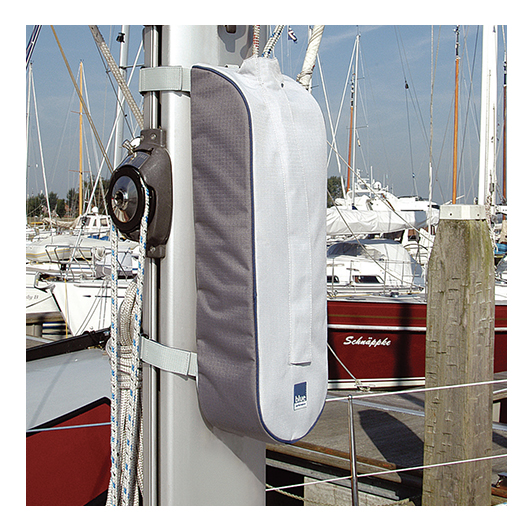

Not sure how big your Try-Sail is.
Blue Performance makes a Halyard Bag in 3 sizes. The large one might fit your needs.
I have it on my mast for my Halyards. Works great.

Thanks, I have two of those bags. I have not used them yet and did try to stuff my try sail in it. It was to small., but sure is a good idea for a new design for bag. Glad to hear they work for halyards, keeping the sun and weather off them long term use a good Idea.
