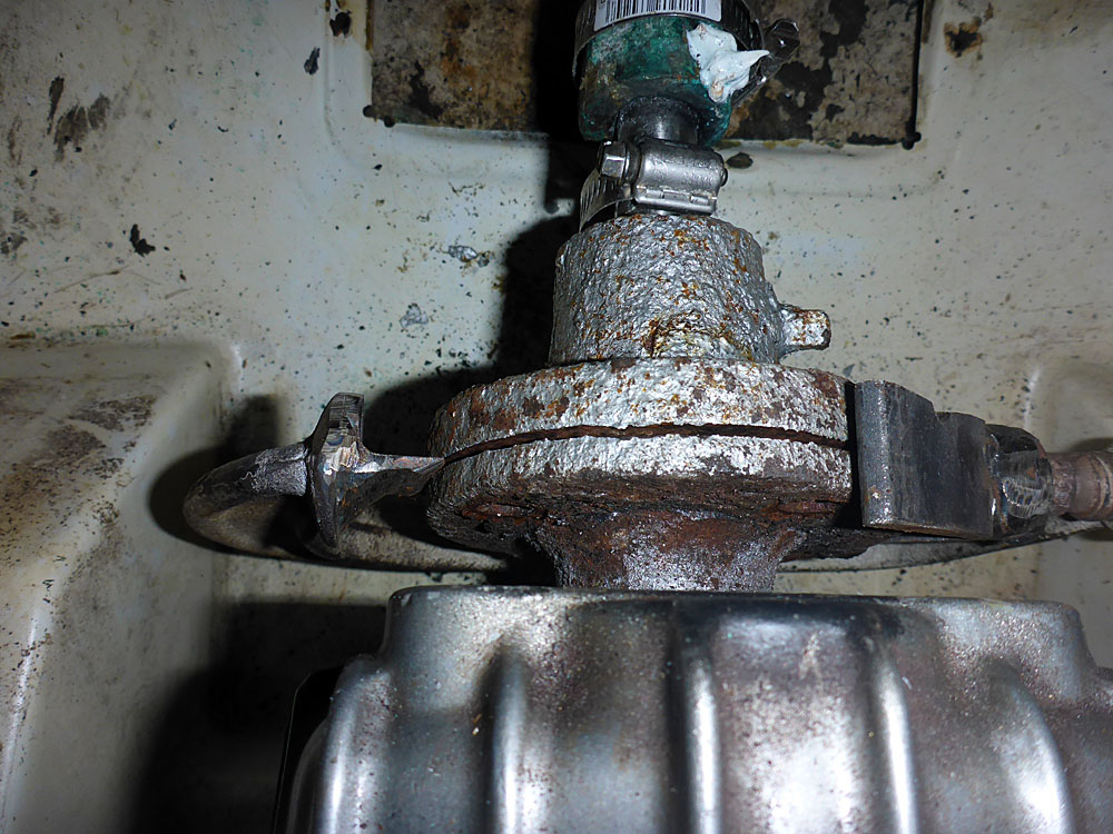

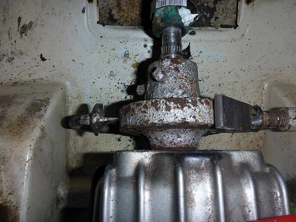

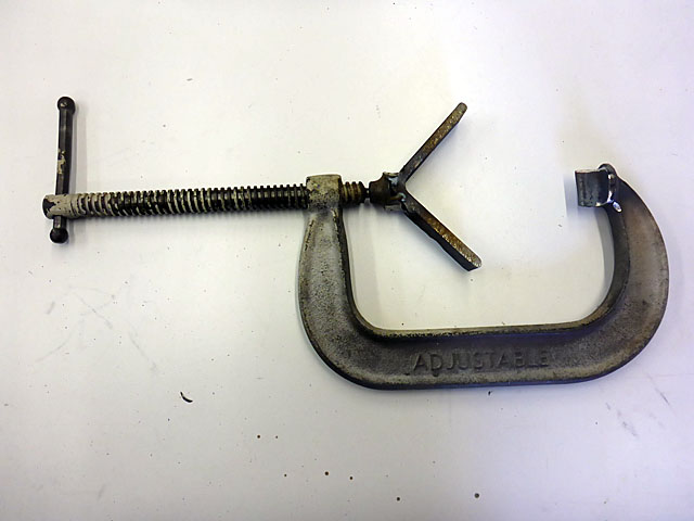

I strongly advise against whacking with a hammer. My friend Neil Dutton fabricated this tool which splits the coupler without banging on it. We used it on my boat and it worked well. We'd be willing to loan it to you for the cost of round-trip shipping.
