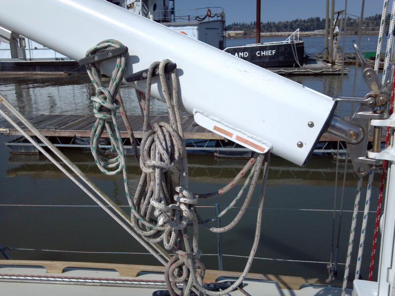

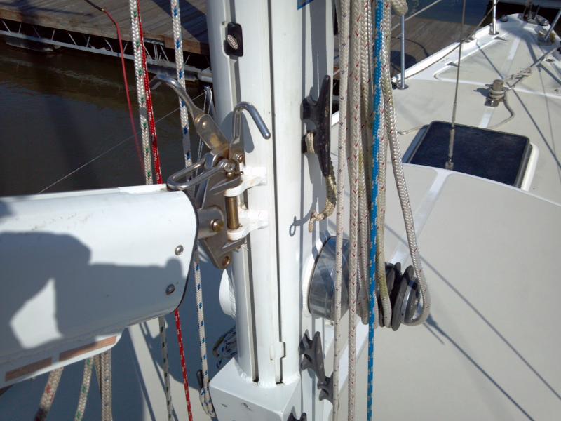

I do have a couple of pictures of the gooseneck... the boom kicker is mounted in the usual way, just like on other boats...
im not sure what I will find if I pull the gooseneck apparatus out of the boom... it may have a hole there to pin it in a fixed position which would solve the immediate issue, if it doesnt create others.
I dont have enough experience with it all to even know what all the hooks, gadgets and 3 winches mounted on the mast are for (1 port, 2 starboard)....or even all the lines coming out of holes in the mast and boom... somethings may be a mystery for a long time yet but in an attempt to learn and remember what they are all for will probably keep me from getting bored with it.:D

It seems to me that a boomkicker wouldn't be intended for a swiveling boom. What is the purpose of a swiveling boom if you don't furl or reef the main on it? Does that cylinder-looking pin actually swivel inside the end of the boom?
I would imagine the 3 winches are for 3 halyards. Main on stb., headsail on port and spinnaker on stb. The hooks (rams horns) are for the reefing grommets. It looks like you have 4 lines exiting the mast end of the boom. I suppose 2 would be for reefing lines, and 1 would be an outhaul. Not sure what another line would be used for.

Scott, the boom actually does swivel on the "pin" where it goes in to the boom. and like you, im not sure why it would need to swivel, ever.
the extra line exiting the fore end of the boom seems to be a downhaul for the leech of the sail.
there is an extra grommet 8" above the clew on the leech where the line hooks to it with a shackle... not sure why its there... the sails all have leech lines in them to trim the flutter away..
when I got the boat, it was rigged with the foot of the sail in the boom track, but the guy at the sail loft said I would get better performance running it loose footed. (not that I could ever tell with my limited trimming skills)
so when I put the sails back on, I rigged all the lines like they were, only without threading the sail in the boom track.

After reading this it seems to me if you threaded the sail into the boom and forget about the loose footed system you would solve your rotating problem. The tension on the sail will hold the boom in a vertical position. I have a boom kicker and it runs from the base of the mast to,a slide (track) along the bottom of the boom. I do not see this in your pictures.
Mar 20, 2012
3,983
without the boomkicker installed and when the sail is inserted in the boom track and it fills with wind, it pulls the boom sideways with the foot of the sail... that is my only reasoning for thinking that it may be designed to do that with the sail and become part of the foil, in the same way a rotating mast acts like part of the foil.....
the tack of my sail connects to the gooseneck and not the boom, so the halyard pulling on it does nothing for, or to, the boom.
and as I have said, the boom kicker is attached in the usual manner as it is on all other boats.... so i didnt feel there was a need to include a photo of it here. (actually, at the time these photos were taken, the boomkicker was removed from the application, which is the reason the boom is in its semi-normal, upright position.)

Have you opened the end of the boom to see how that pin attaches inside? Your answer might be in there. Perhaps you will find a way to attach a plate inside that will lock the swivel in place.

I agree with others that there's no reason for such a boom to rotate. I don't see any advantage in sail shape from such a motion. Pin it, weld it, replace the gooseneck or otherwise fix that. The boom kicker should really only be carrying the weight of the boom when the sail is down and possibly in very light wind. Otherwise, you want the boom held down by at least it's own weight, and depending on the conditions also held down by mainsheet and tension on the kicker. Holding the boom up with a topping lift or kicker when under sail will usually give you too much sail twist and a generally inefficient shape. The cringle you mentioned 8" up on the leech of the sail is likely for a reefing line, and there should be a cringle on the luff at about the same height which will go around one of the horns at the gooseneck to reef. With regard to the loose foot trimming of the main - is there a slug near the clew that stays in the sail track? Every loose footed sail I've seen has a slug there to keep the clew close to the boom, and trying to loose foot a sail without one would likely chafe the outhaul and be difficult to trim nicely.

There is no aerodynamic advantage to the boom rotating with the sail, especially since your are using a loose foot main. I would try to find a boom end fitting to fit your gooseneck that will stabilize the boom.

A rolling boom was designed to allow roller furling of the main around the boom. No other reason. It was not a great idea, caused other problems (like the one you have) and stopped being offered about the time Carter was president.
Like any rigid vang, a boomkicker cannot be used with a rolling boom. It says so in the the manual.
