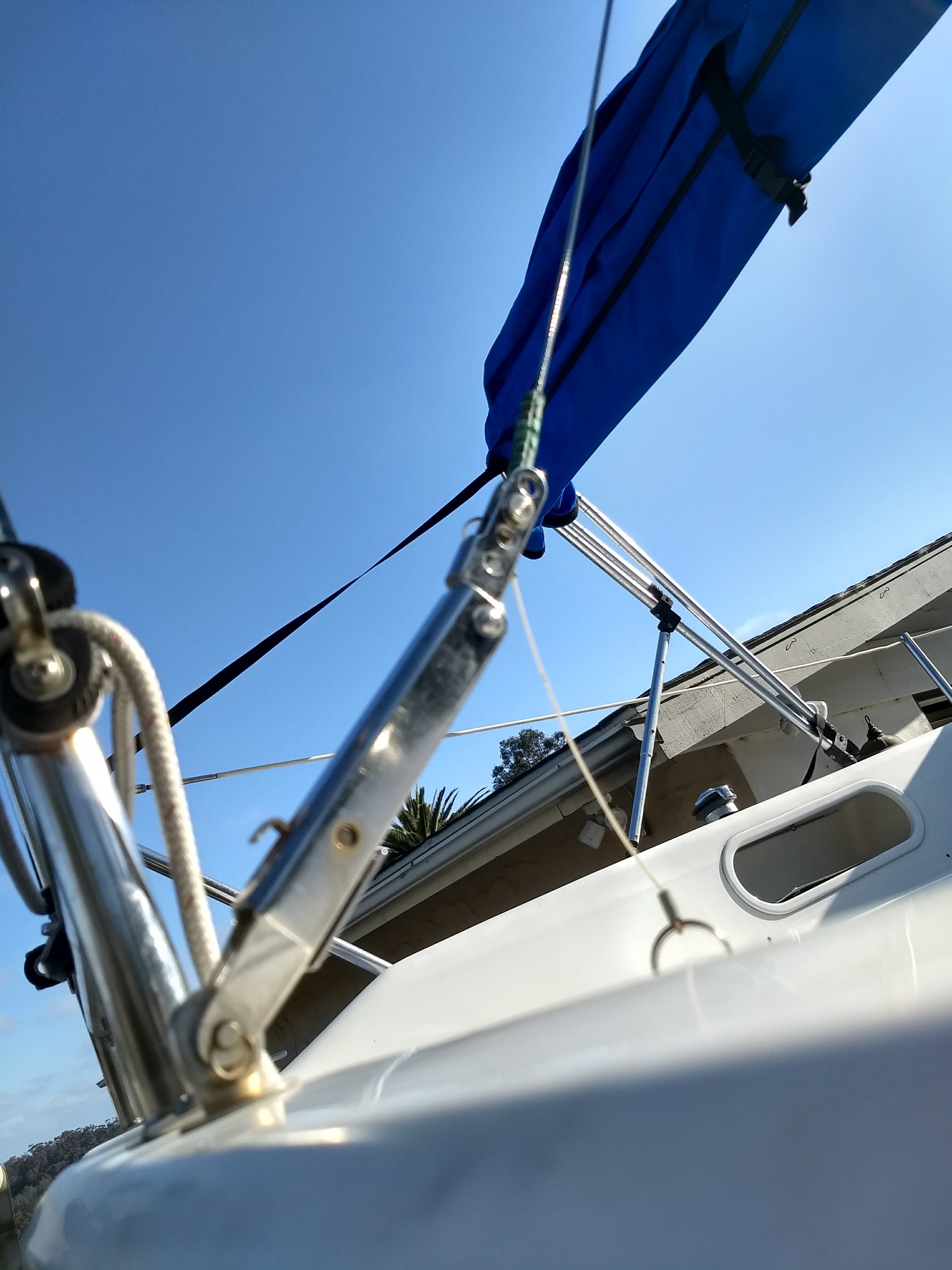

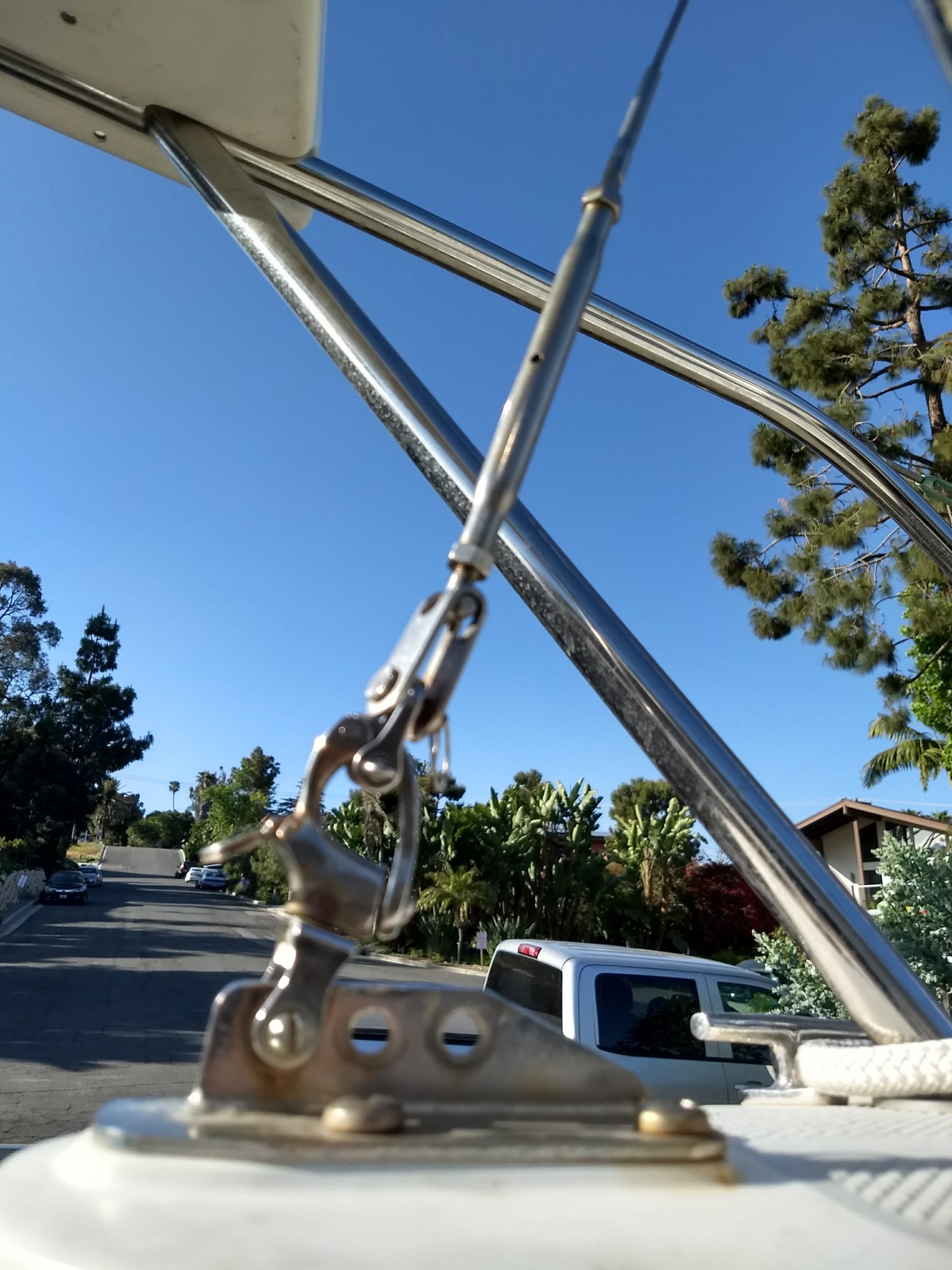

When I try to tighten the fore and aft stays, I run out of adjustment length on the turnbuckles before it's tightened. I know I have a bit more room on the back stay quick release, but even at the tightest setting, I would still be a few inches short.

My first thought is, take off the quick release shackle. That is not a good idea anyhow.
Next, check the rake angle on your mast. I don't know what the rake for your boat should be, to a small extent, it's your preference, but there is a design tolerance you should work within. There are others here on SBO that will know more about that. Set your rake by measuring/adjusting the forestay. Tighten down the backstay so it is tight but not tight enough to cause the mast to bend.
If you don't get the rake you need after removing the quick release shackle, a longer 'U' shackle may be in order. You still have two settings of adjustment to shorten your backstay. If that isn't enough, you might look into a shorter turn buckle.

It looks to me like you have attached your forestay to the stem fitting with a snap shackle! That is a HUGE no - no. You shouldn't even use the extra shackle that is used as an intermediate fitting. That U-shaped fitting that is attached to the toggle should be pinned to the stem fitting with the clevis pin. Most folks would also have a problem with that ring ding that you have on the pin. A cotter pin (split pin) is what most folks use. Removing the 2 shackles should eliminate the slack. The snap shackle is used for the sail tack, not the forestay. HTH

And change out that closed-body turnbuckle for an open one.

On the forestay lose the snap shackle (bad in this application.) Use a U shackle with a clevis pin. Change closed body turnbuckle for an open one.
On there backstay lose the quick release and use another U shackle.

Right of the bat I see you have the forestay hooked up wrong. The "snap shackle" is for the sail's tack and should be pinned to the second or third hole in the stemhead. The turnbuckle for the forestay is then pinned to the leading hole. If you raise and lower the mast a lot, you can use a "quick release pin" for a little more convenience with the turnbuckle. But it's not that much of a hassle once you get used to the split ring. Does that make sense? You should now have plenty of thread to adjust your rake.

Alright.....now this is making sense. I think five of you told me how to do it right, but the way Joe phrased it hit home.
I didn't think that the last owner could have been too out of whack regarding the rigging. I found a loos gauge in the cabin which leads me to think that he cared to tune it somewhat correctly.
I re-connected the forestay. I am thinking that the quick release on the backstay is to facilitate easier trailering. The tension is now good. Assuming the rake is correct....this should be alright? .....Except for the evident difference of opinion regarding the snap ring, cotter pin, or quick release pin issue.....and the closed turnbuckle.
