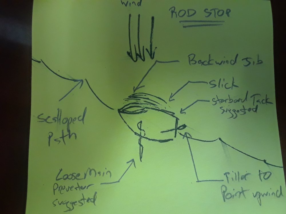

One other cool benefit of always using the jib on the 170 is heaving to.
Backwind the jib or tack without changing the jib sheet. Let out the main and the turn tiller as if tacking again. Hold in tiller in place.
The 170 will stop and drift slowly. We do this regularly for snacks or getting lines untangled.
When ready to go just change jib sheet straigten rudder then start pulling in main.
