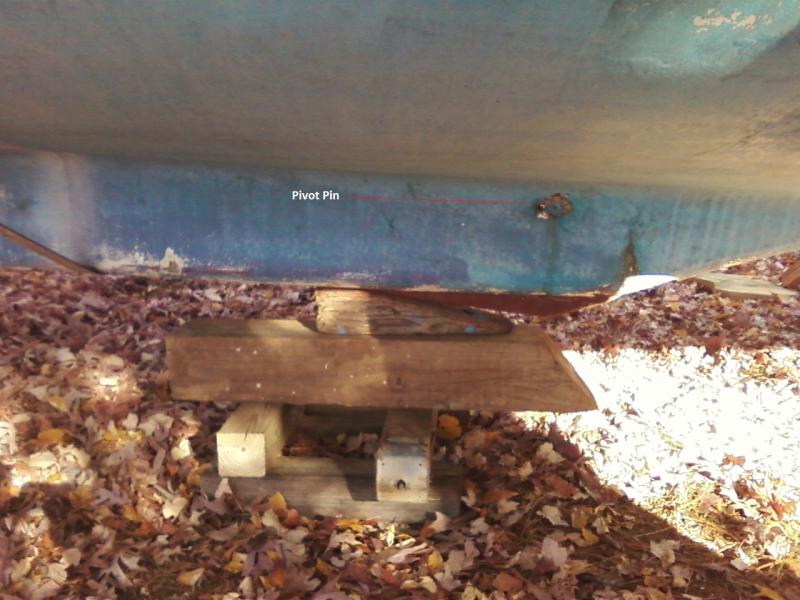

I'm not familiar with your boat but I had an idea anyway. I've been working on a Rhodes 22 and on that boat the swing keel pivots through a pin attached to a keel UNDER the boat. To get to the pin, the boat has to be out of the water.

We took it off the trailer on the lawn and propped it sideways - pulled the keel out - unfortunately no sign of the pin. Poking a wire up the casing didn't locate any slot - can't help thinking we must be missing something! Thanks your comment. John
