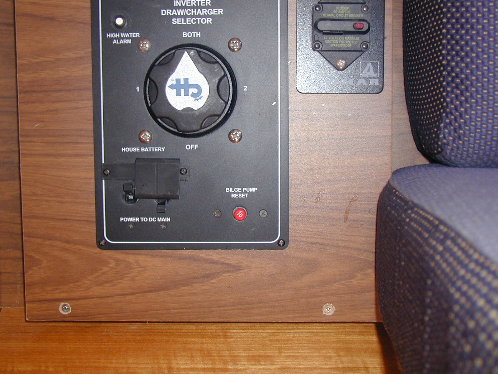

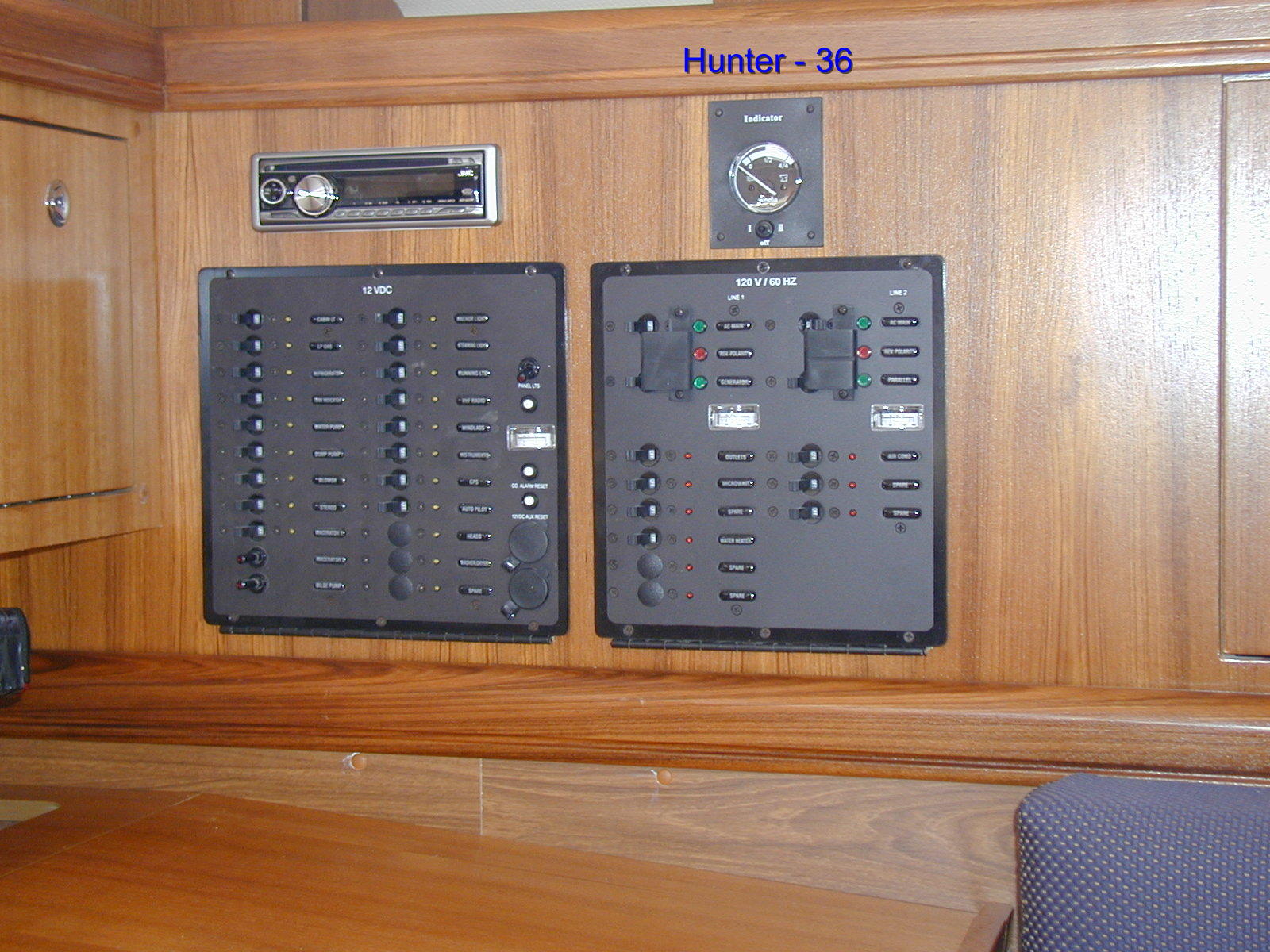

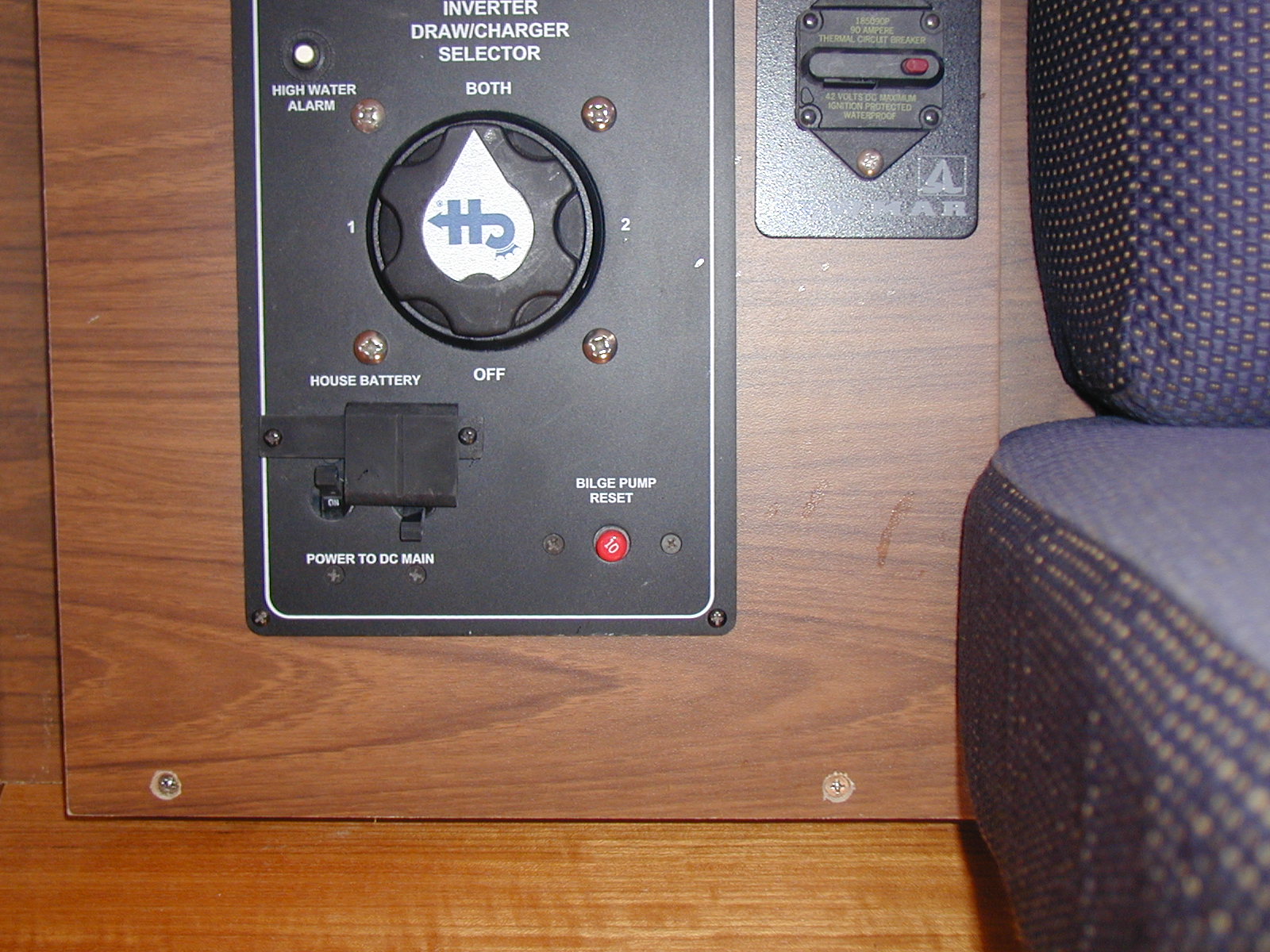

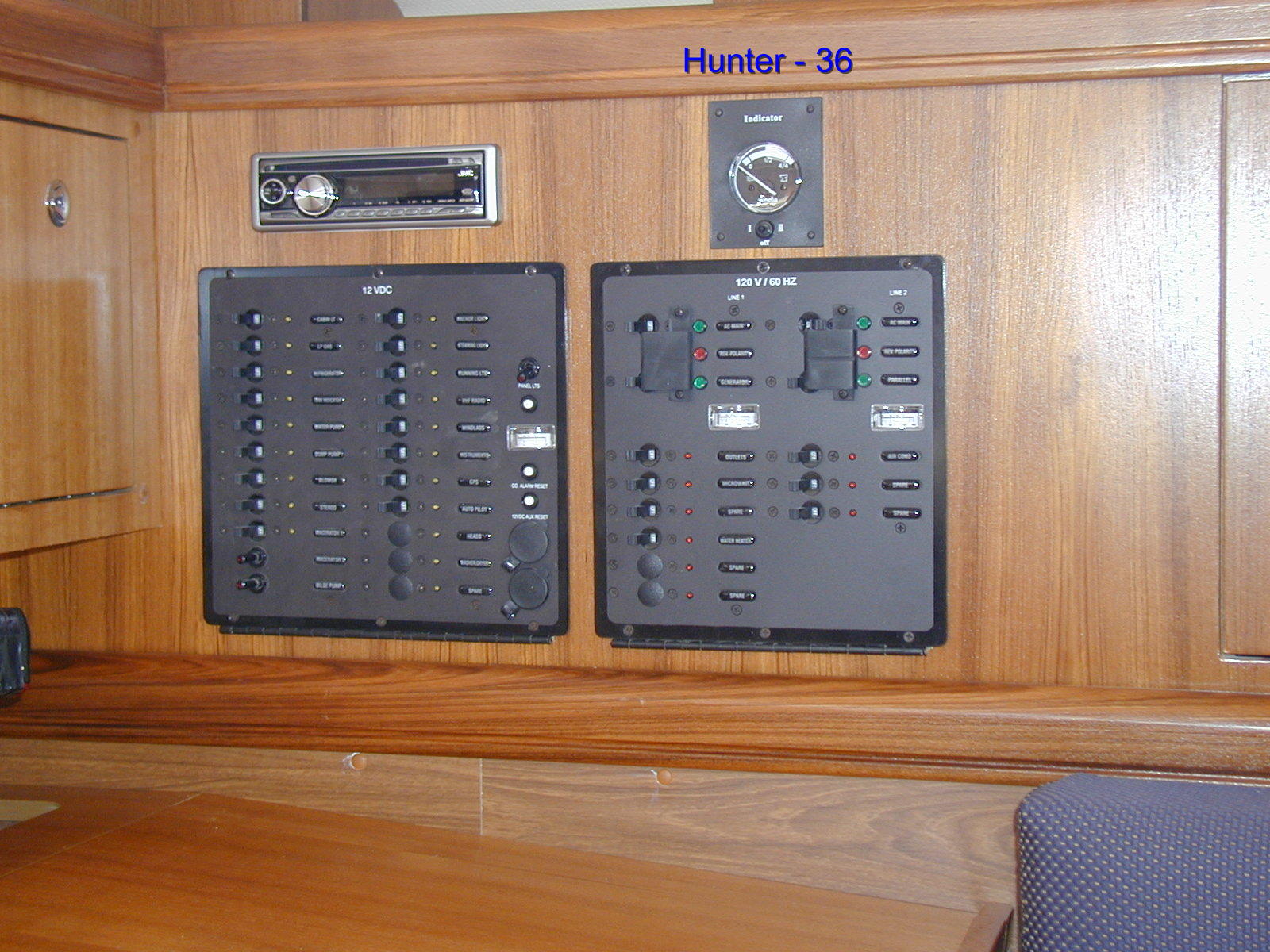

I will show you with photo my main panels and don't know if you can see on the panel on right and the bottom breaker is a crossover breaker that allows my to use everything with just on 30 A plug.
Been doing this one plug for many years and know not to use any other heavy draw at the same time as the AC and my wife just asks and I just shut down the AC to turn on hot water.
It was all factory installed by Hunter, Gen,Inverter/charger,AC and I did add the solar and I insisted that everything be installed at the factory and not dealer.

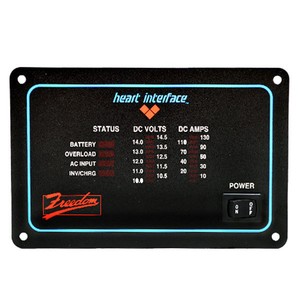

Very nice! This is all I have on board my Hunter to monitor my system. It's attached to my Freedom Combi Inverter/charger. Much room for improvement
