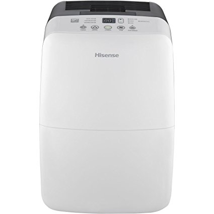

HanBan you can help the issue, by reducing the moisture. Get a dehumidifier unit at Lowes or your choice of stores.
I have one on my boat and it does a great job of keeping the air less humid, less inviting to mold and mildew.
It has a fitting to connect a hose that can be connected to a drain.
