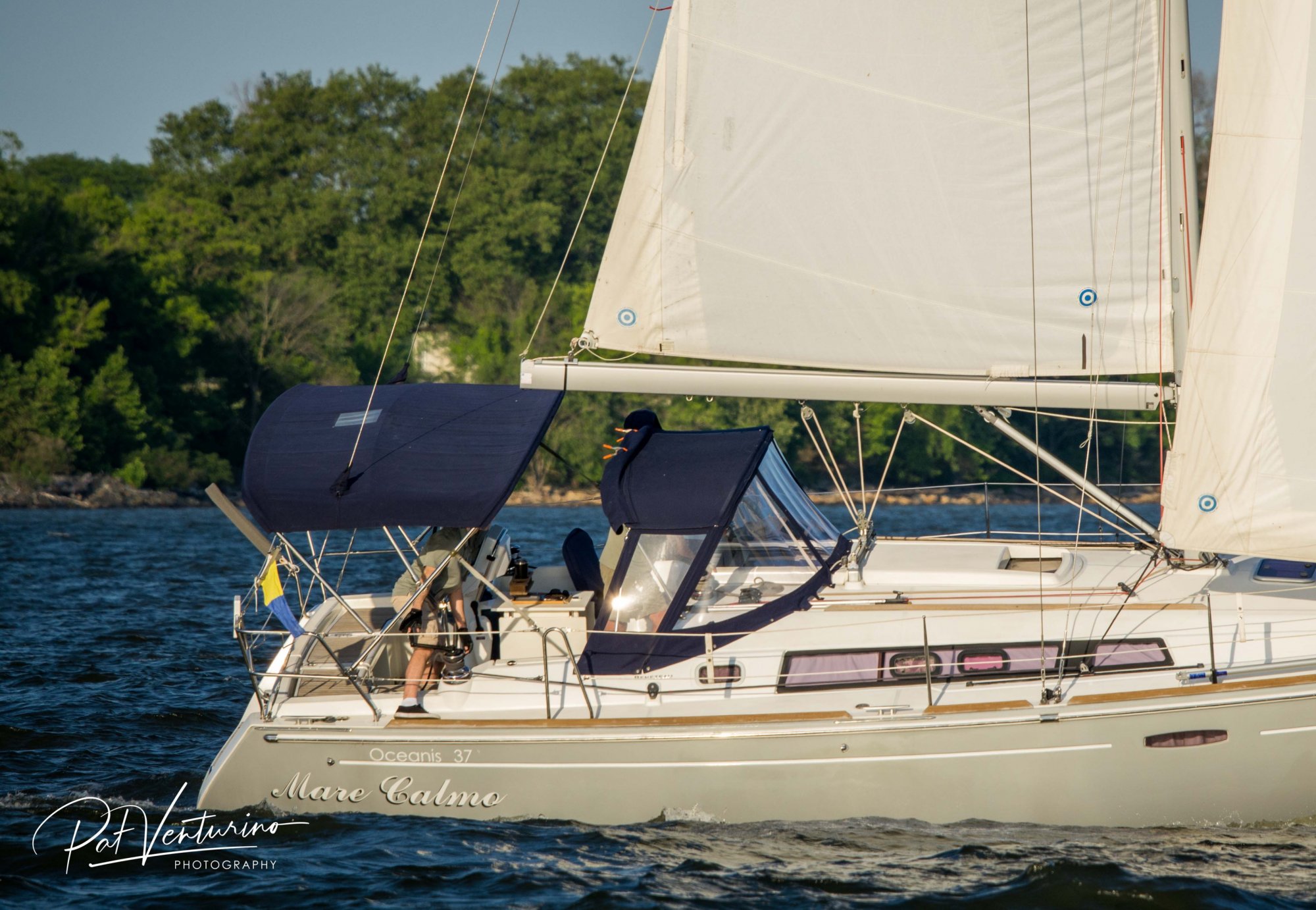

I’ve got lots of complications- it’s a dual backstay (split from the masthead) that goes up through a Bimini. The Bimini is large enough that reaching the backstays is pretty hard without leaning all around at funny angles half outside the boat.
This might give you an idea of the layout -
Incidentally those pigtails to the backstay scare me when I see them on smaller boats. If the sail fills before the pigtail is released it looks like it could get exciting.
