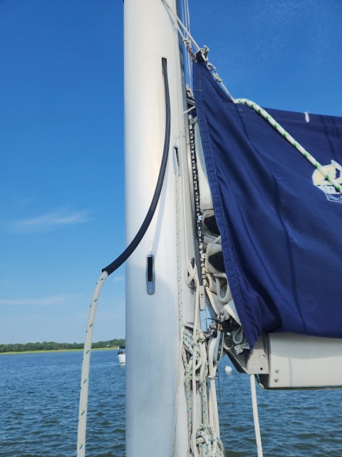

Thinking some more (as my wife says, "I hate it when that happens") I am going to try to feed one of the same irrigation hose up the mast from the bottom to where the halyard feeds out from the mast. Then the mast climber (not me!) can reach in and feed a small chase line down to me on the deck and we can be sure the chase line didn't wrap anything on the way down as might be possible.
Brainstorming here, I may tie a chase line inside the hose with a loop at the top so all he has to do is reach in above the sheave with a hook and grab the chase line, attach it to the new halyard and I pull it down. Any other suggestions.

In case I wasn't clear. Here is a picture of the irrigation tube up the mast.
